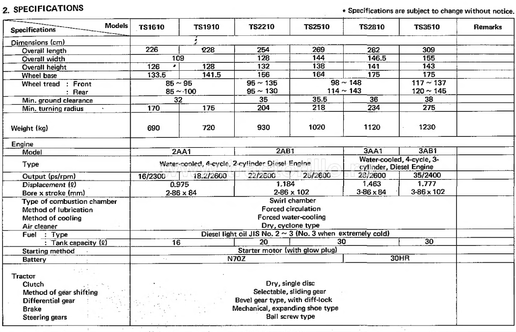

I bought an Iseki tractor yesterday from a nice older couple who didn稚 use much and really didn稚 know much about the tractor. They told me the model was a TS2202f. When I got home and started researching parts and service manuals I found that the TS2202 is a 3cylinder. I am no mechanic but when I open the hood there appears to only be 2 pistons on the block. So unless Iseki designed an engine with the third cylinder under the engine block which I haven稚 found I am guessing they had the wrong model number. After scouring this forum and TractorData.com it looks like the TS**10 tractors are 2 cylinder tractors. Does anyone have any suggestions on how I can determine what model Iseki I bought?? I really want get the manuals and filters so I can service it before I put her to use.
Thanks in advance for any help and/or suggestions.
Tad

Check the wheelbase. If it's a 2 cyl diesel with a 61.5 in wheelbase its mostly likely (almost certainly) TS2210. If the wheelbase is in the 54 in range its either a TS1910 or TS1610.
   / Newbie needs help with tractor ID #7
You can also check the model number of the engine. That will be on the lower right side, if you're facing the tractor. The table I have in the manual for TS**10 series shows:
2AA1 goes with TS1610 and TS1910
2AB1 goes with TS2210 and TS2510
3AA1 goes with TS2810
3AB1 goes with TS3510
The first digit indicates whether it is a 2 or 3 cylinder.
