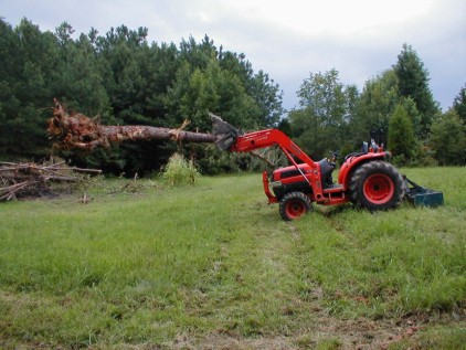

The first thing I had to learn is how to work smarter with it, rather than trying to use brute force on everything. Since I got a back hoe, and love to use it, if I cannot push it over with the FEL I just dig around it a little and then push it over with the BH (up to 9"). Larger trees, which I must rip a lot of roots out for, and don't know if I can control it, get cut with the chain saw, then I dig the stump later (10" and larger). I moved all felled trees with the 4 in 1 bucket on my 723 loader.
You will find digging roots with the FEL very slow going. While it can dig just fine, the roots stop it easily and will cause you to make slower progress than with a BH. What I'm trying to say is it will be worth the money in the time you save to rent a BH or a stump grinder. If you do opt to rent a large backhoe, you will find it can push over many trees the 3830 cannot.
See my web site for trees I have moved:
http://www.Stamey.Info/Tractor/AtWork1.htm
Chris
