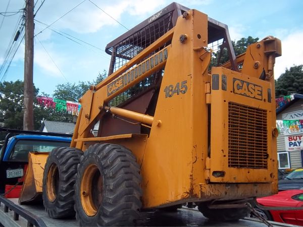

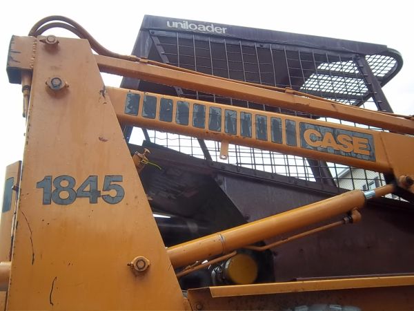

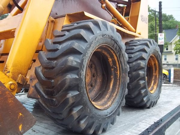

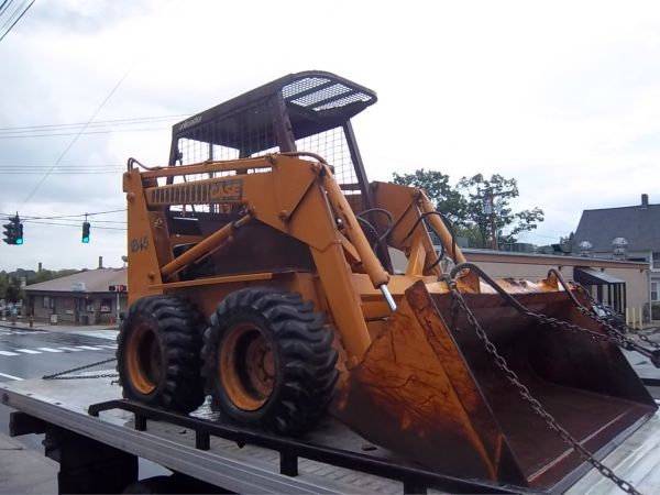

I just found this ad on my local CL for a Case 1845 Uni-loader Skidsteer - he's asking $8,100
Thoughts?
i have a case1845 uniloader skid steer in exellent shape well mantained stored inside machine runs new tires are in great shape ready for work nice machine oh and did i mention its diesel best resonable offer takes it
5L25I45G73E83L53N5c667535244262cc1c77.jpg5L85Ia5F73M73Ld3Jcc66e09a28dd668c1ab2.jpg5L75Je5M93Jd3pa3l2c66bf37f0a6091e1530.jpg5G85M25J13Gb3If3J5c66f3704986b64310e6.jpg
Thanks,
Eric

I guess I'm confused as to getting a TLB 4x4 or a skid steer? I would like to have a backhoe (dig up rock/brush/stumps) and a skid steer can't do that w/o a backhoe attachment. Since I have been so used to having a standard L&G tractor, my JD 212, I am at a loss as to what kind of machine will suffice with my budget and knowledge. :confused:
   / Newbie TBN looking for advice on 4x4 tractor #8
Sounds like you really want a tractor (instead of a skid steer) for the wide variety of tasks you want to do. The 3-pt hitch and rear PTO that come standard on CUTs really opens up a lot of possibilities that are otherwise extremely expensive to attempt with a skid steer.
However, your overall desires present some contradictions. But don't despair! I had the same set of goals when I did my own tractor search this past winter.
Your already know your price of under $10k is going to keep you stuck with a well used/older tractor.
However you want to do some pretty serious work. Dig big rocks out of the ground? Smooth large areas of dirt? Clear a lot of brush? These are all tasks where the larger (read: heavier) and stronger the tractor, the easier they are to do. 25 HP would probably be the bare minimum you want. 35+ HP would be better, but you'll be hard pressed to afford it. And with proper tractor weight to match, you're going to be well over 3k pounds (with loaded tires, front loader, and an implement or two coming along on the trailer).
My advice: forget about your current trailer as a limitation for how big a tractor you can get. You can easily find a used trailer on craigslist for around $1000 that will have dual 3.5 or 5k lb axles. Or, rent one for $50 a day from nearby rental places. Sounds like you have a good half ton truck to pull with, right?

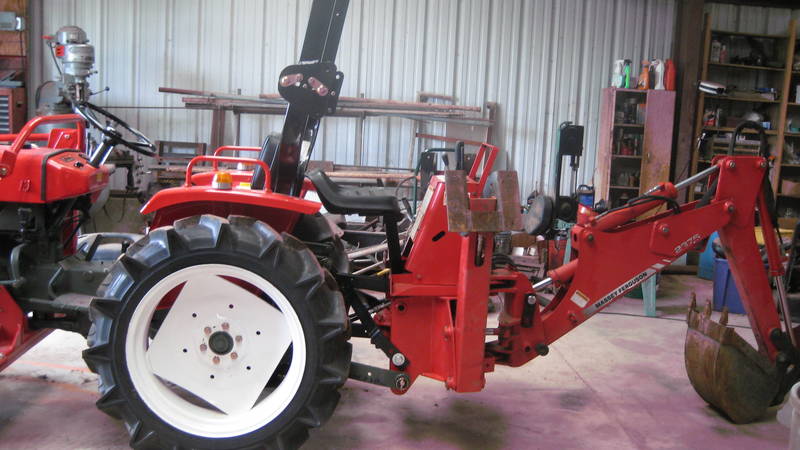

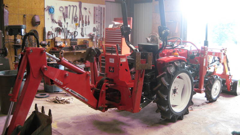

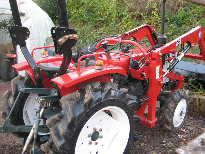

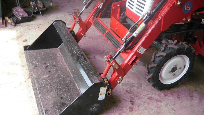

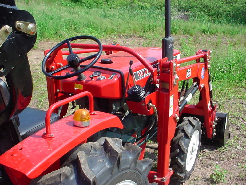

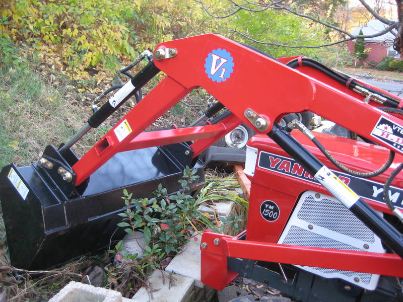

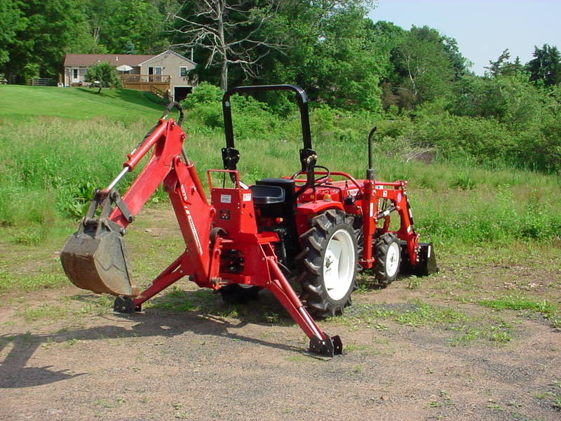

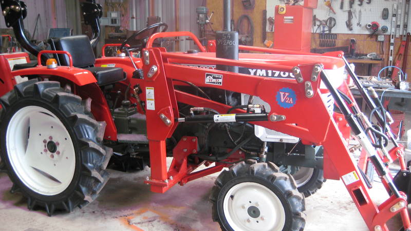

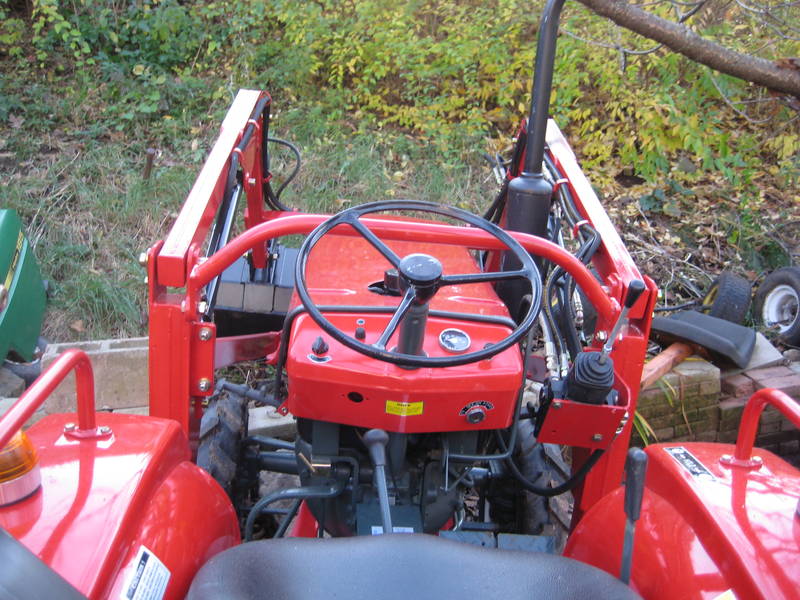

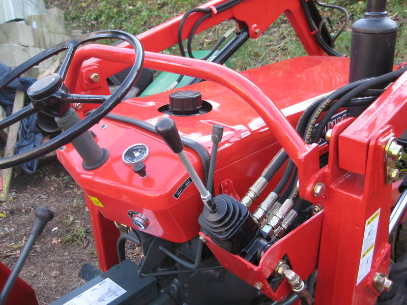

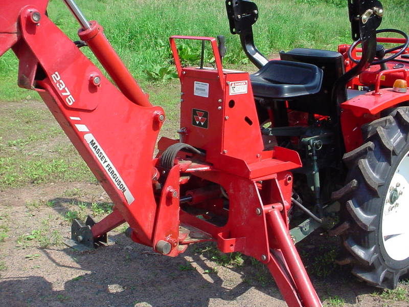

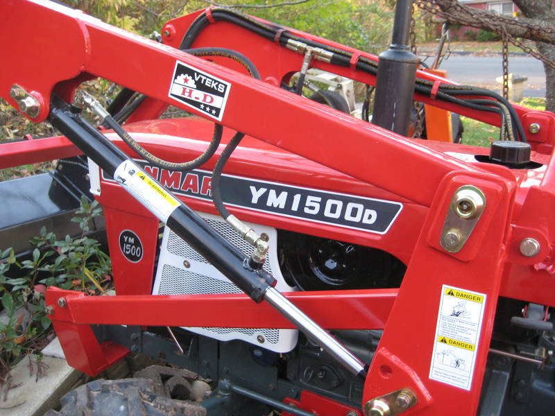

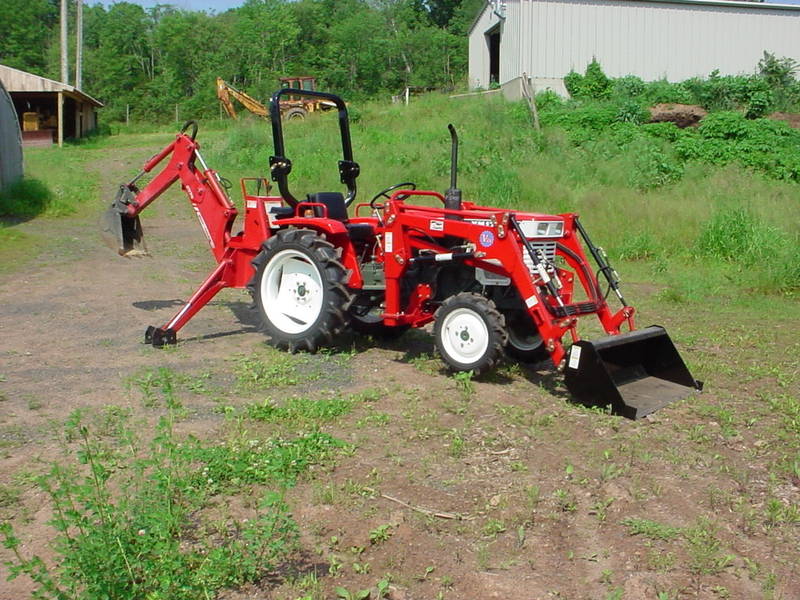

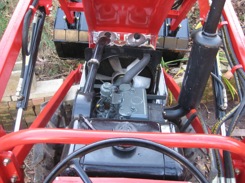

Nice setup! I hope to find a good deal one of these days. Searching very time-consuming though. I know that higher HP is the way to go, but maybe I could start with something like this and eventually work my way up to a larger HP tractor. What do you think of this? It's a refurbished Yanmar tractor. This guy has (2) models available.
1st Model
Price:$7,000
Date Posted:06/08/12
Description:
FOR SALE IS A YANMAR MODEL YM1500D, 4X4 COMPACT TRACTOR, 19HP YANMAR DIESEL ENGINE. TOTAL OF 6 SPEEDS FORWARD AND 2 REVERSE. NEW FRONT LOADER AND REAR 3PT HITCH, 2 SPEED 540 & 770 REAR PTO AND A CAT 1 3PT HITCH. TRACTOR HAS ONLY 16 HOURS ON IT.
YANMAR_YM1500D-6.jpgYANMAR_YM1500D-5.jpgYANMAR_YM1500D-4.jpgYANMAR_YM1500D-3.jpgYANMAR_YM1500D-2.jpgYANMAR_YM1500D-1.jpg
2nd Model
Price:$10,500
Date Posted:05/28/12
Description:
FOR SALE IS A YANMAR MODEL 1700 COMPACT TRACTOR, 4X4 WITH NEW LOADER,REAR PTO,CAT. 1 3PT HITCH AND A MASSEY/FERGUSON BACKHOE. TRACTOR HAS APPRO 16 HOURS ON IT. LIKE NEW CONDITION. PLEASE CALL OR EMAIL ME FOR MORE INFORMATION ON TRACTOR. YOU WILL NOT BE DISSAPOINTED.
YANMAR_YM1700-8.jpgYANMAR_YM1700-7.jpgYANMAR_YM1700-6.jpgYANMAR_YM1700-5.jpgYANMAR_YM1700-4.jpgYANMAR_YM1700-3.jpgYANMAR_YM1700-2.jpgYANMAR_YM1700-1.jpg
   / Newbie TBN looking for advice on 4x4 tractor #10
Hmmmm. Both tractors have 16 hours on them? More than 4 pictures, means they weren't craigslist ads?
My first instinct is just that both are very small and lightweight tractors. It's not to say that you can't do some serious work - but it will undoubtedly take you longer vs a larger machine.
That backhoe looks decent, but is only mounted on the 3-pt hitch. It could probably tear the tractor in half that way if you were really aggressive with it. Would recommend you fabricate a sub frame mount if you end up going that way.
Might be worth a test drive though. I just tried using searchtempest.com to check your area (CT) for used tractors. Yikes, man! The scammers are out in force over there (all the listings for new tractors priced between $4400 and $4900. Obviously all scams... why bother cluttering up the lisitings? ugh.
