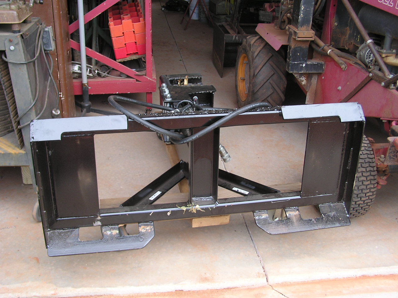

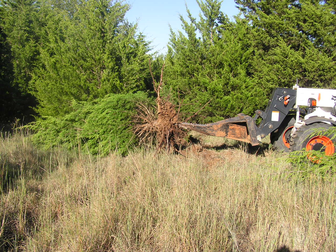

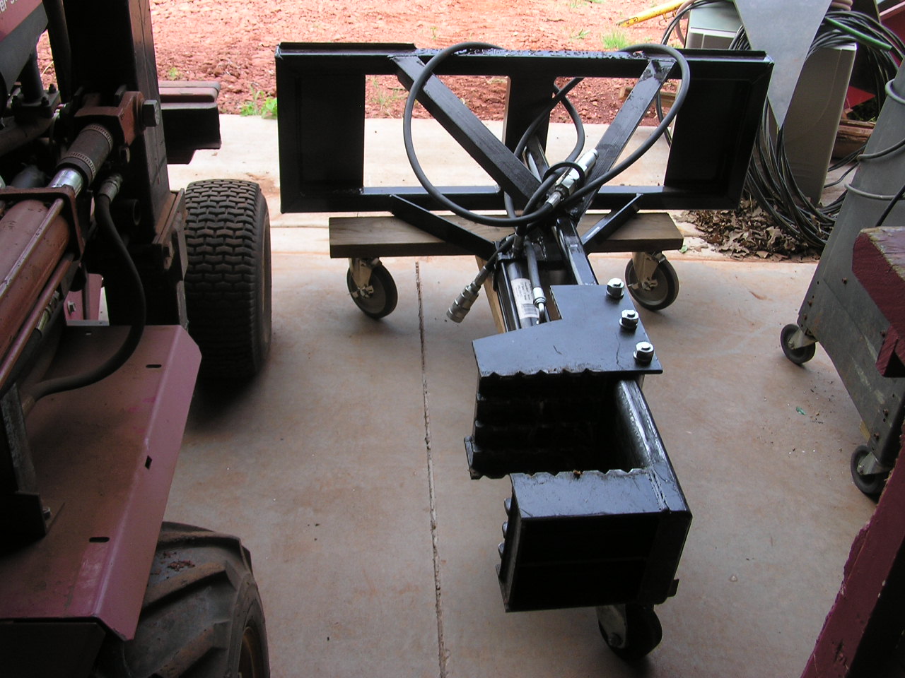

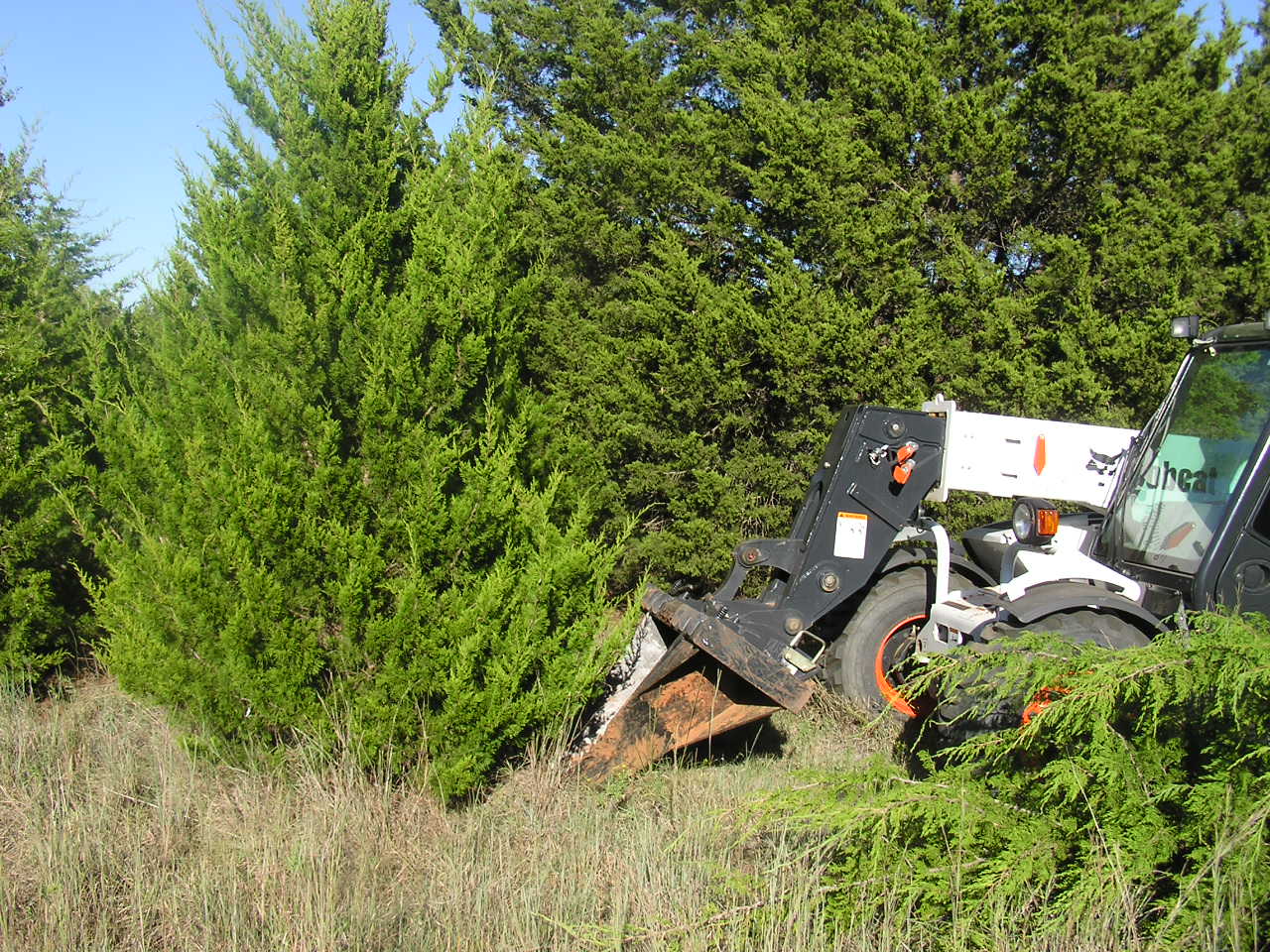

This is what I use, cedars do not have a tap root: http://www.tractorbynet.com/forums/attachments/277824-tree-puller-post3345203.html#post3345203
