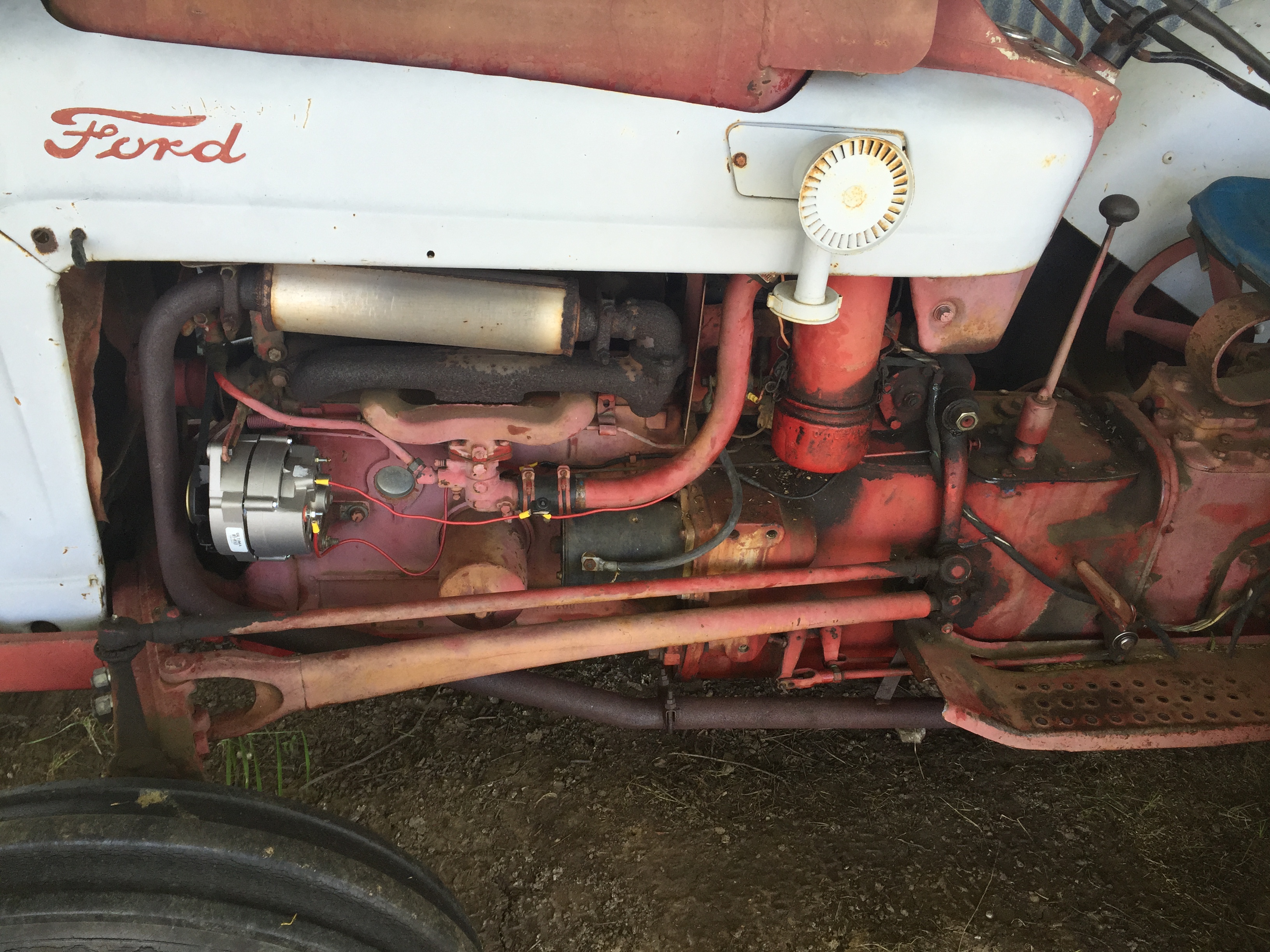

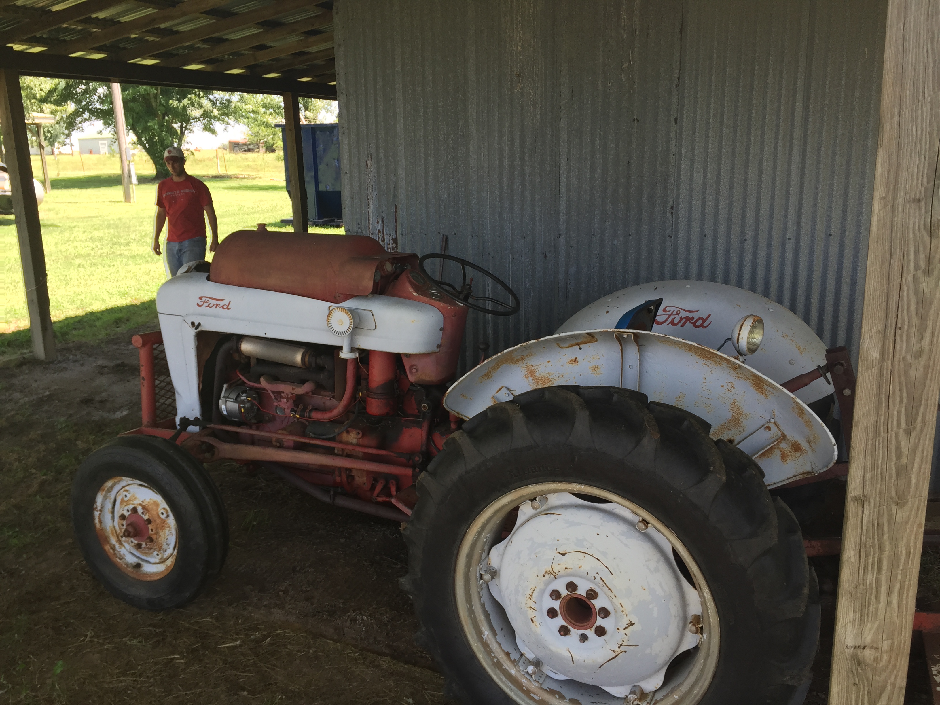

New to the forum and hoping to learn all i can about my tractor. I bought a property a few years back with this Tractor Included in the purchase.
Initially the Tractor did not run, but with the help of a local mechanic and a few dollars, it runs pretty consistently today. I have been told the Tractor is a 900 series or a Jubilee (Which i think is incorrect). But if there are any experts out there that could help with a positive ID-It would get me started in the right direction for parts, etc.

With that tank on top it's obviously an LP gas variant. A serial number will go a long way to identifying the model and year. As Thomas suggests, have a look at TractorData.com for more information: TractorData.com Ford 94 tractor information
This may not be your tractor so explore.
Enjoy the site.
   / Newbie-Trying to Identify my Tractor #4
Your tractor is a 1956 or 1957. 600 series model 650 or 800 series model 850. Show a photo from the rear and I'll tell you which one it is. Of course LP which I'm sure you already know.

Kirk what the heck kind of shifter is that?
   / Newbie-Trying to Identify my Tractor #6
It's a 5 speed shifter.
   / Newbie-Trying to Identify my Tractor #7
Agreed with Kirk.
Post us the number off the flat on the trans bellhousing and we can better identify it for you.
It kills me when someone tells the new owner of their tractor that it is a NAA or 900.. LMAO... not even close... you wonder where people get that from..
