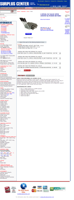

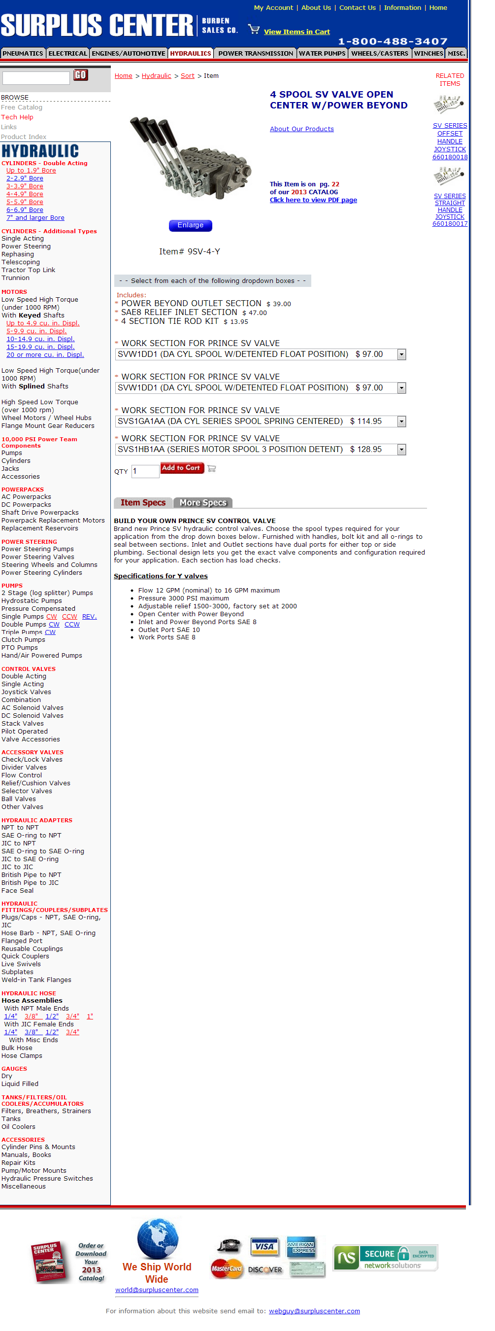

Hydraulics:
Type: open center
Pressure: 2133 psi [147.1 bar]
Pump flow: 6.1 gpm [23.1 lpm]
Total flow: 9.6 gpm [36.3 lpm]
Steering flow: 3.5 gpm [13.2 lpm]
Do you want ford parts or do you want to save about half of dealer cost?
How about a 4 spool remote for $537.85 plus shipping.
You will also need some fittings and hose and QD's.
Two of the spools have float, and one has 3 position detent.
One is just spring centered .
   / Newbie wants to add remote Hydraulics for a Kelley B15 backhoe to New Holland/Ford 19
JJ,
Thank you for the reply. I think I really only need a single remote....perhaps I am mistaken there? Do you recommend parts for that?
Also, I am trying to understand where to tap into the oil, and where to return it.
Thanks again,
Shannon
   / Newbie wants to add remote Hydraulics for a Kelley B15 backhoe to New Holland/Ford 19 #4
I thought that perhaps you wanted to do a lot more with your tractor.
As soon as you install a one spool valve, you will want more.
If you do the one spool stacked valve, you can add to it at any time.
For a single spool monoblock valve I would recommend this valve.
Surplus Center - 1 SPOOL 14 GPM PRINCE WVS11B5C1 DA VALVE
If you have a FEL, you can install the valve downstream using the PB flow from the FEL.
If all you have is 3pt, then you can take the pump flow and feed the IN port of the new valve, and then using the PB adapter, feed the 3pt. The OUT port will go to tank.
