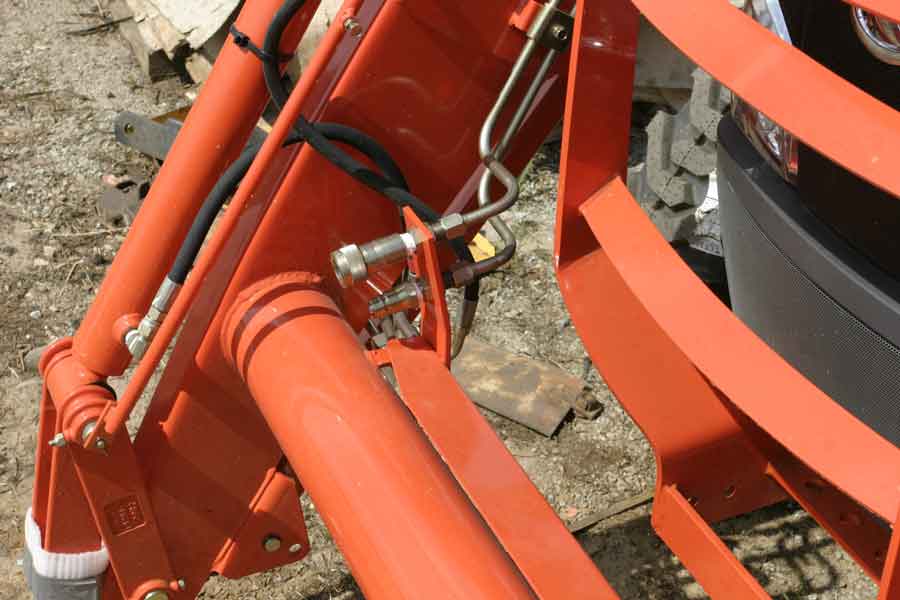

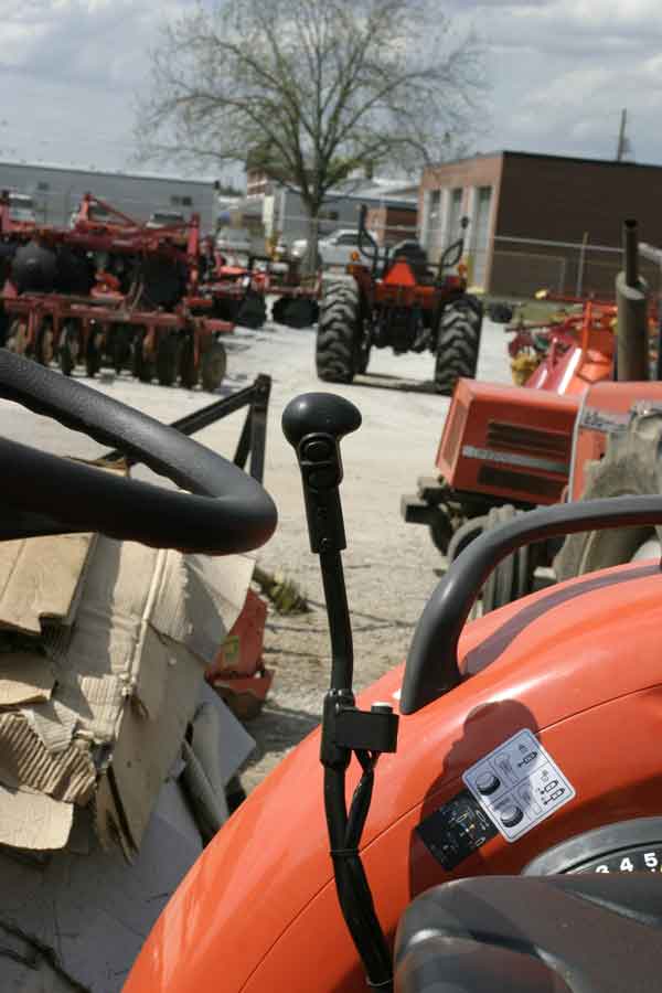

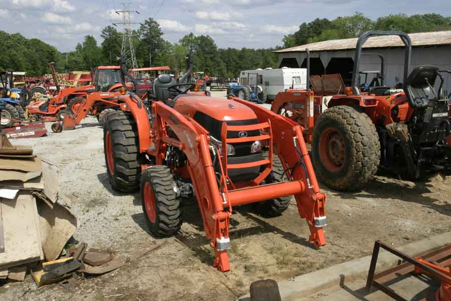

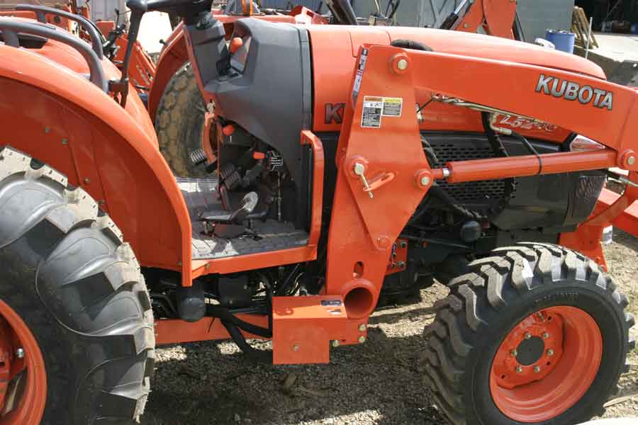

I had just ordered a L5240 with the kubota brand vs wr long 3rd func control because some of the wr long installs were pretty tacky.......not the wr long controller just sloppy work from dealer.
Here are some pictures. I won't actually pick it up until the wrlong bucket arrives
