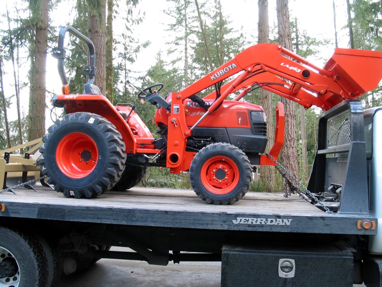

My new toy (um, tractor) arrived! I feel like a kid at Christmas time. :D
Used it a little yesterday. It's a lot of tractor for my 3 acres, but I have no regrets.
