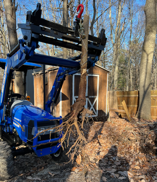

My tractor's not much different from yours. I think ericm979 is right about how hard it is to pull plants out of the ground with the loader.
I've made it work by putting a hitch and hook on the FEL and tying cable or chain around the small tree trunk, which I've cut off about 4 or 5 feet up. This lets the FEL pull it up, and the tractor bend it back and forth. I'll pour water around the trunk with it in various stressed positions, to churn up a little mud around the roots and weaken the bond there. However, this does take some time. I doubt it's an option for much acreage.
