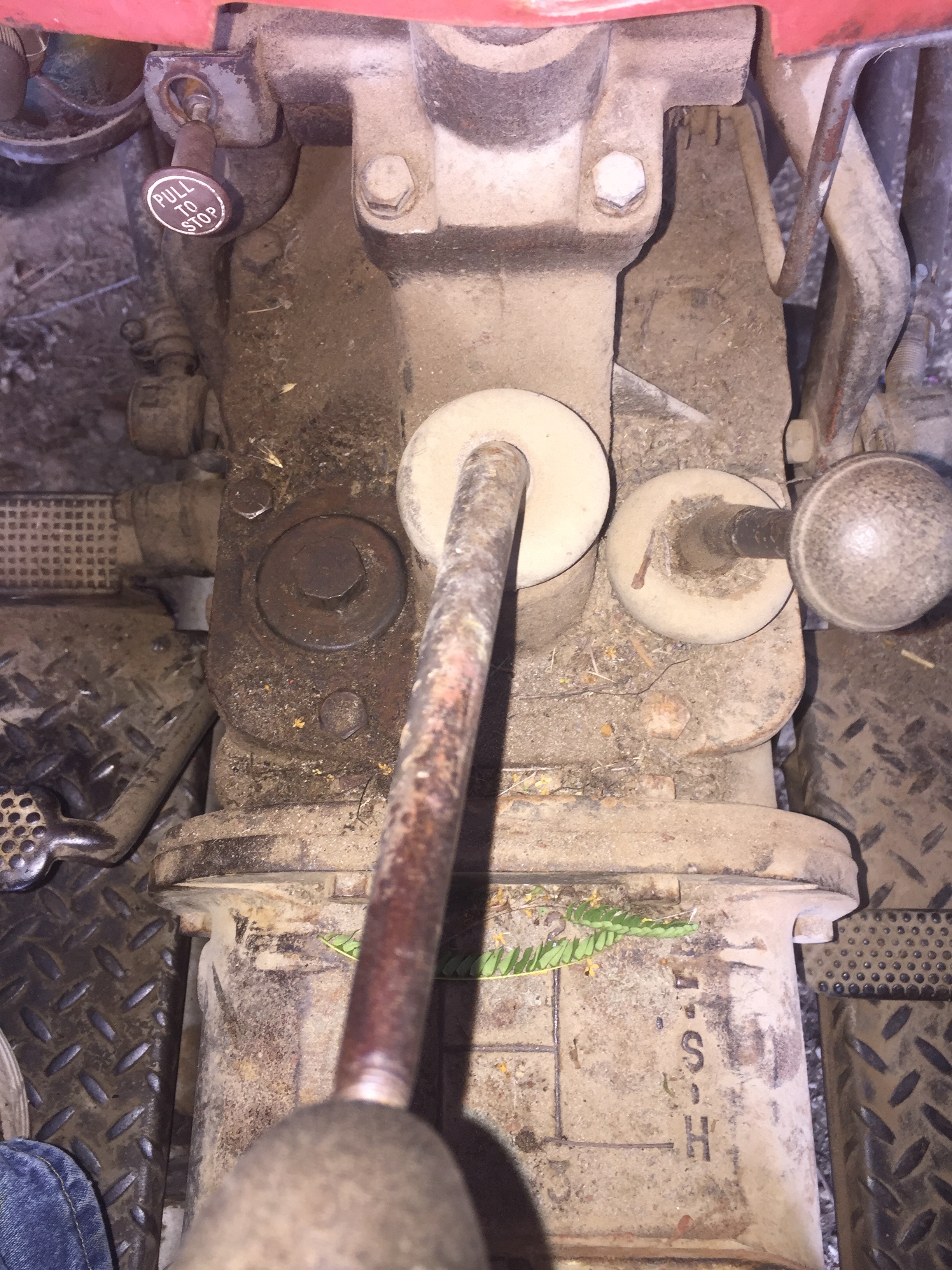

Any suggestions for removing a MF 135 transmission fill plug?
Heck: What's the exact size? 1inch? 7/8 inch?
I ordered a new fill plug and the it's inch, but the plug on tractor is not responding to a 1-inch socket (could be because of rounding). I do not have a 7/8 socket or metric.
I don't have a welder to tap-weld another bolt on top.
Suggestions?

Need a pic. It was probably metric. All my dad's MF stuff is metric and all my LS stuff is metric.
Things that could work:
Splined socket
Vice grips
Pipe wrench
E Z Out
Chisel and hammer

A splined socket or splined wrench will take that right off. Carefully file those squished edges off first to give you maximum bite. You may have to lightly tap the socket/wrench on with a hammer. Hold pressure on the socket/wrench and hit the top with a hammer. It will come right off.

Ditto on the filing. I've been able, in several instances, to file enough on the sides of the hex head to be able to get a slightly undersized socket to fit & bite. Just try to ensure that the filed areas are perpendicular to the mounting surface, not sloped.
You MAY have to tap the socket down onto it, and if you can find a socket (6-point, preferably) that has slightly rounded internal points, that socket style will transmit more of its torque to the flats of the hex head rather than on the points of the hex head, generally a better way to go. Might be well worth the cost of a socket.

UPDATE:
I was able to break nut free with impact wrench. It's just touch getting to bolt head.
Thanks for the help.
