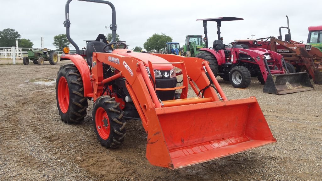

Hey guys,
New to tractors. Just purchased a Kubota L3301 tractor W/Loader. Seems to be in excellent shape with 265 HRS.
I downloaded the owner's manual to do a basic service before I start using it.
I want to change the engine oil first thing.Is it important to use Kubota filters and lubricants?
What about air filters and screens? Are there any items that I should look out for?
A local implement dealer has a Bush Hog Razorback BH5 with the slip clutch for $1,400.00 Will this work well with my tractor?
I am just cutting a 8 acre hay field with it, no heavy brush or trees.
Thanks in advance for your time
