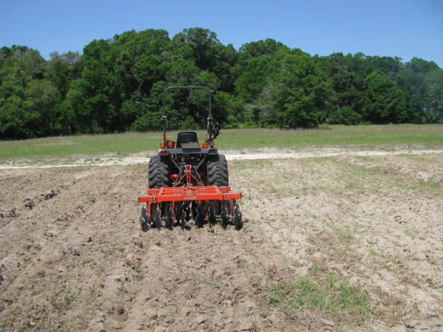

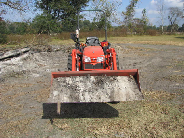

I drive a Kubota B3300SU, 33-hp / 1,900 pounds with Front End Loader / 4-WD. One increment larger than the Deere 2720. I think the Deere 2720 would be BARELY adequate.
In the 1980's I used to visit Lake County, California, looking at wine grapes for Fetzer Vineyards. i remember the soil as being rocky, dry, and hard where the wine grapes are grown. My B3300SU is just adequate pulling implements over Florida sandy-loam, which is rock free and usually moist.
I do not know your specific conditions but I would look for a tractor-loader with closer to 40-hp and 3,000 pounds, including FEL and certainly 4-WD and a Category 1 Three Point Hitch. Tractor weight makes considerable difference in your ability to get work done. Also, you do not want to run your tractor wide open to get your work done in Lake County's hot summers. Tractors overheat, like cars, when overworked.
More implements, new or used, are compatible with Category 1 three point hitch than other Categories.
I really like my Kubota but there are a lot of good tractor brands. Tractors in the compact tractor category are assembled from imported components.
