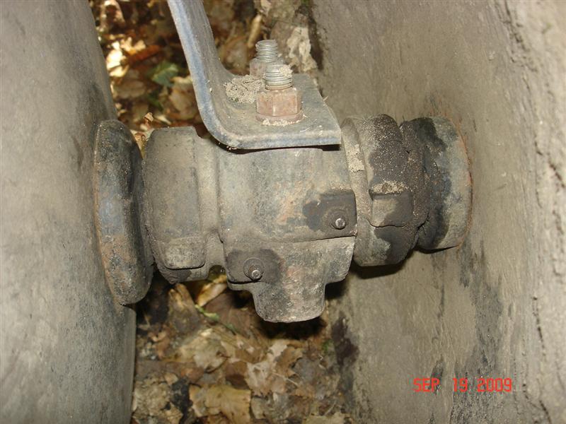

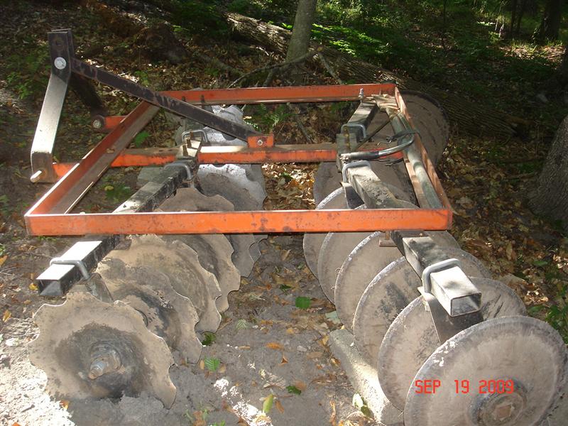

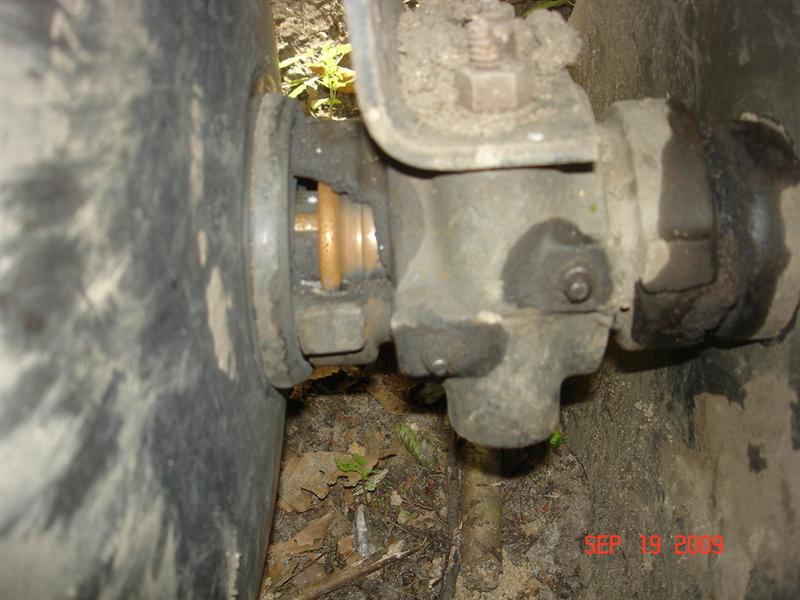

I have a 4 gange disc with a broken casting, the one with the grease fittings on it that supports the shaft. I have not been able to find the mfr name on it. It is only a few years old. The 4 shafts that the discs rotate on are about 4 ft long. Can I find parts for these at tractor supply or do I need to look online? I haven't taken the shaft assembly all off to tear it apart to see what else may need replacing yet. Thanks.

Try Shoup, Valu-Bilt, Agri Supply, ect. The cast "boxing" used on most of the newer disc's is a common, "generic" style. (There are TWO different types though, easily identified by the style of spool..... that's the spacer between disc blades, internal to the casting) Is your broken one the top half or the bottom half?

I followed the instructions provided and hope to now have pictures. I took the disk apart this weekend to see the extent of the damage. I will be needing both sets of cast parts, the outer casting that has the grease fittings and that the support bolts that fasten it to the hanger on the upper frame of the disk.. I also need two of the inner castings that look to be the bearing surfaces that ride in the outer casting that is broken. I see clearly markings on the outer (broken) casting as follows. There is a CFG-2 and a S inside a vertical oval. Do these numbers or logo mean anything to anyone who can help me ID the manufacturer of the disk so I can find these parts?
The design looks like the outer casting has grooves that the raised ridges on the inner casting ride in. Looks like just grease keeps the two sets of surfaces from wearing. I can not see any seals but maybe they have distroyed themselves and are gone.

THANKS DJ54, You are the MAN. And this site is the PLACE. Now I have the manufacturer and model of my Disc and the parts are ordered. Thanks again.
