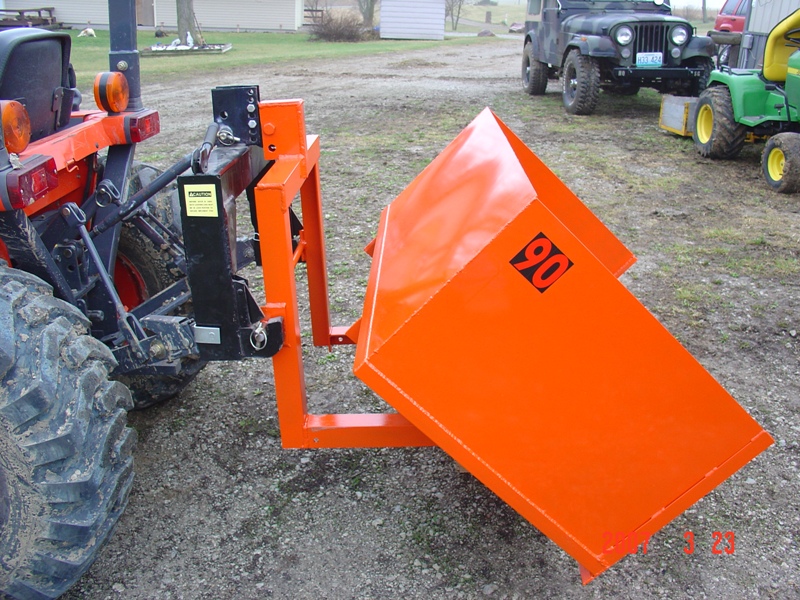

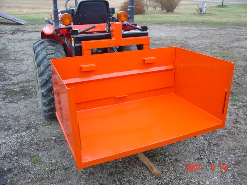

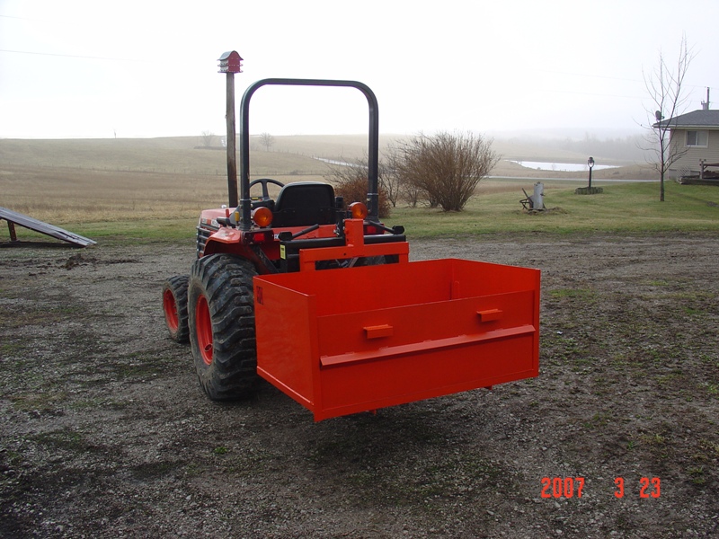

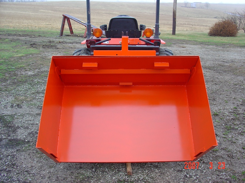

Hey guys/gals, just wanted to share information on the newest Kubota attachment. It's the 90 series Tote Box. All steel construction. Easy Tilt. Removeable tailgate that stores conveniently in the front of the box. Quick Hitch compatable. Can be painted in any color. Not sure how many of these will be produced. I seem to have the prototype model because I haven't seen any others. Great attachment and the price was right!!! ;)

Nice job. I like the way the rear hatch stores away.

That looks great. I can see a need for this since it is QA compatible.
I need some specs.
LxWxD.
and the big one, how much?
almost forgot, I hope their is a locking mechanism for tilt capbility otherwise I'll have to add one.

Good looking tool, interested in the size, and if I order one, will you throw in one of the new fangled exhaust stacks in your first picture, especially the fancy rain cap.:)

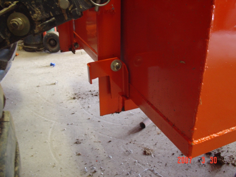

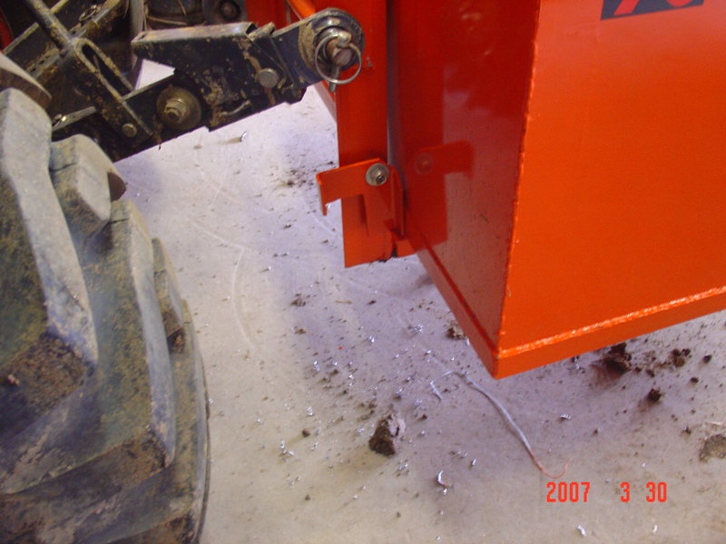

My first task with this box was to haul a load of firewood. Just as I started to back in the shop, the box dumped, spilling the load. So I went inside and built a latch, see attached pic. As for the dimensions, I bought a 4'x8'x1/8" sheet of steel and cut out a 48"x30" bottom, 48"x20" front, two 30"x20" sides and the 48"x16" tailgate which left me with a small scrap of steel. 2.5"x1/4" angle iron make the frame. 1.5"x1/8" angle iron forms the frame around the bottom and the rear corners with short pieces making the guides for the tailgate as well as the holder brackets in the front. The dump hinge pins are 17" from the front of the box. Total cost is $160. I couldn't believe how high priced steel is right now. Poor timing on my part!!! But it will last me a lifetime. Future plans are to add a dump cylinder when I install rear remotes on the tractor.
As for the aftermarket exhaust on the tractor, I had to order that special!!! :p

Actually the way the latch is designed it would relatch when the box reset itself so that's a thought.
As for hydraulic dump, I'm all over that as soon as I get rear remotes!!! :)
