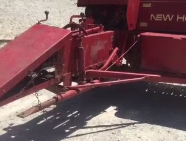

Would anyone with a hitch on a 311 be able to send me a picture of what it looks like? I need to make one, but I need to see how it's designed and where it connects to the baler. The parts breakdown that I saw doesn't show how it works.
   / NH 311 wagon hitch #2
I snagged this shot off of a sale video. If you have the support already, then its just a pipe inserted with a flattened end with a hole. Parts breakdown I saw showed the frame element and braces. Have that already ?
Thanks for the pic! Mine has none of the hitch parts. I just wasn't sure where to attach it. Looks like I'll be doing some fabricating soon.
