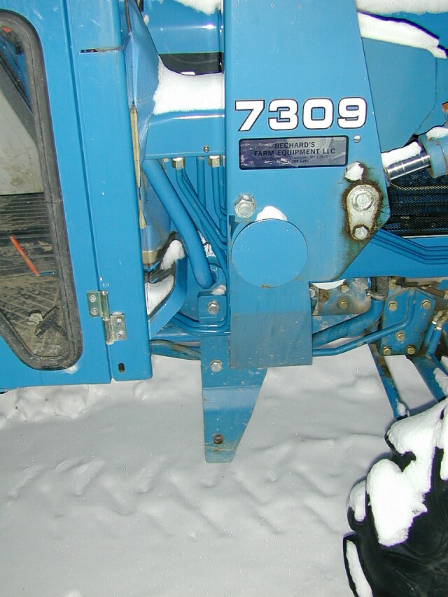

   / NH 758C Backhoe ?s #8
Attached is a picture of the front mount on the right side. A pin on the right and left side hold the subframe in place. I'm not sure how your pins will come but mine are ground into a blunt point so you can drive it in with a hammer. On my NH 2120 I'm lucky in that there is an elongated hole on the floor boards (for clutch and brake pedals) that I can see the two front mounts while backing up into the hoe when hooking up. So basically I can make micro corrections by turning the wheel while backing up. But I still need to be perpendicular for both sides to line up. I find this to be the hardest part.
   / NH 758C Backhoe ?s #9
Attached is a picture of the rear mount. I call it a "mouth" becasue no pins or bolts hold it in. It is mounted below the draw bar (where all the dirt is in my photo).
Hooking up the hoe:
I first back up over the subframe close enought to get my hoses from the hoe hooked up to the tractor. I then lower the stabilizers to lift the sub frame of the ground. I then use the boom cylinder to level the subframe. I get the subframe to the approximate height of the mouth and front mounts. Then I back the tractor up till I'm about 1/2" aways from my mounts making slight steering adjustments. I can guage the distance from the tractor by looking through my holes in the floor. I get off and look, just to make sure and adjust as needed. Get on the tractor and back it in all the way. Then I adjust the height of the subframe for the front mounts by the boom cylinder, put in the pins. The only hand tools I use to hook it up is a hammer on the front pins. The only thing I did care for is the backhoe is "loose" in the rear mount. I've used mine very hard and haven't had any problem.
Hope this helps.
