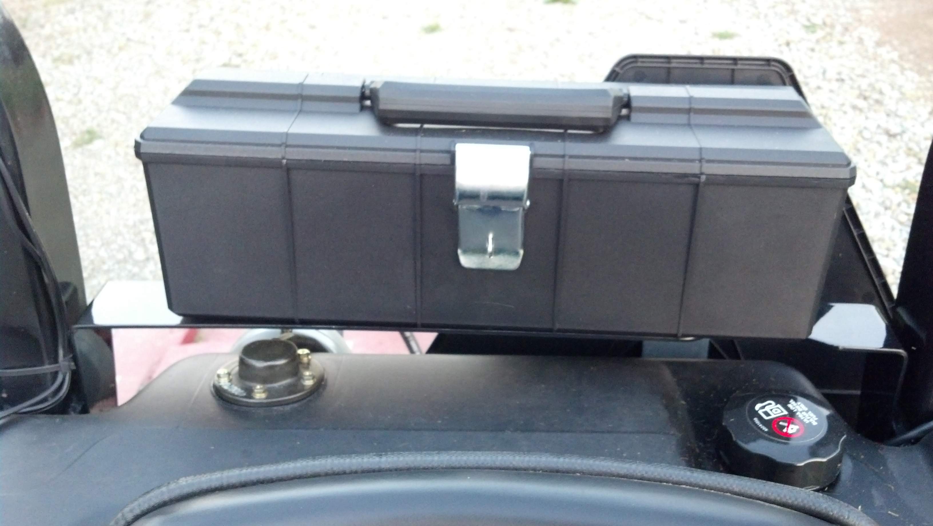

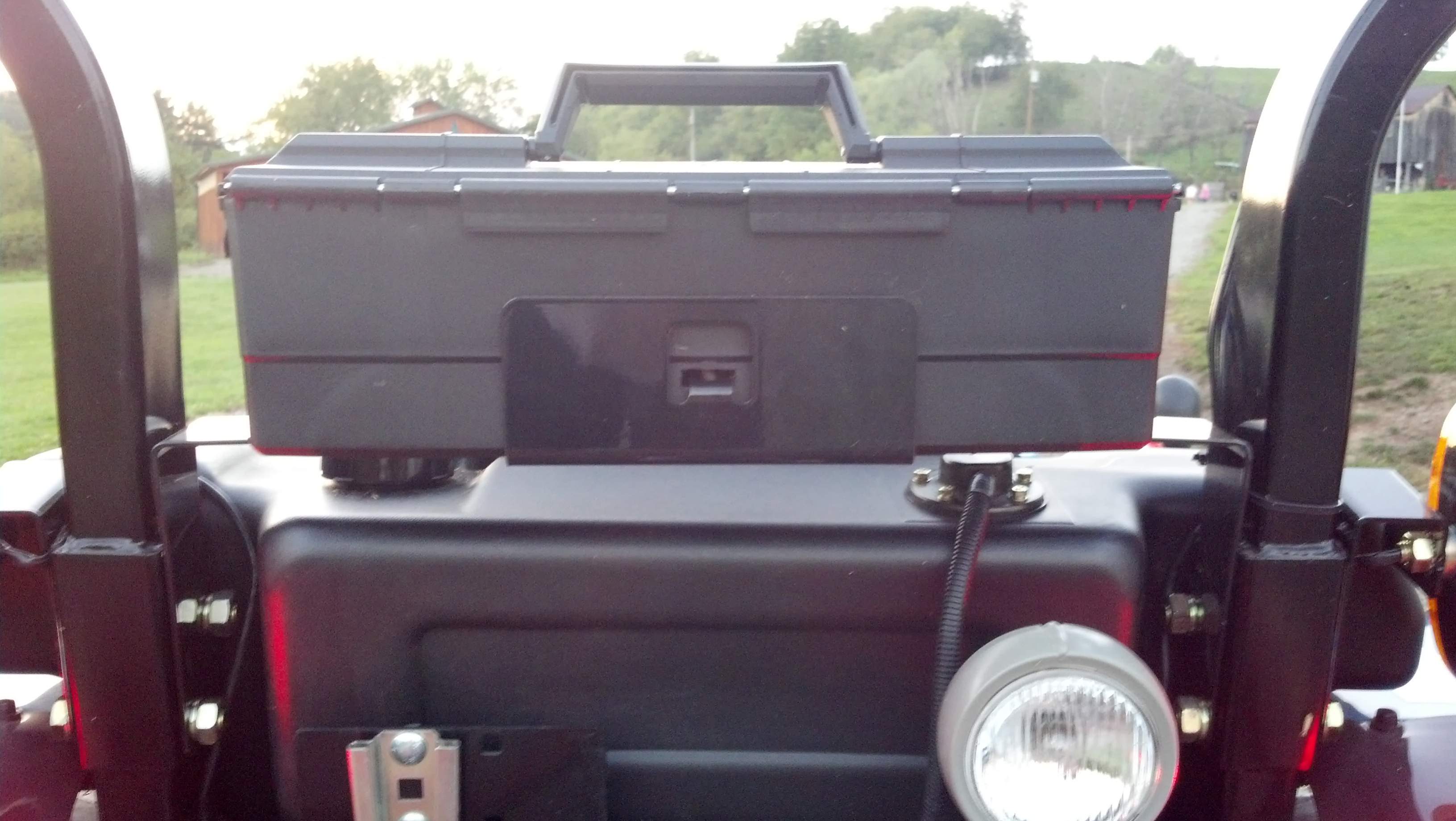

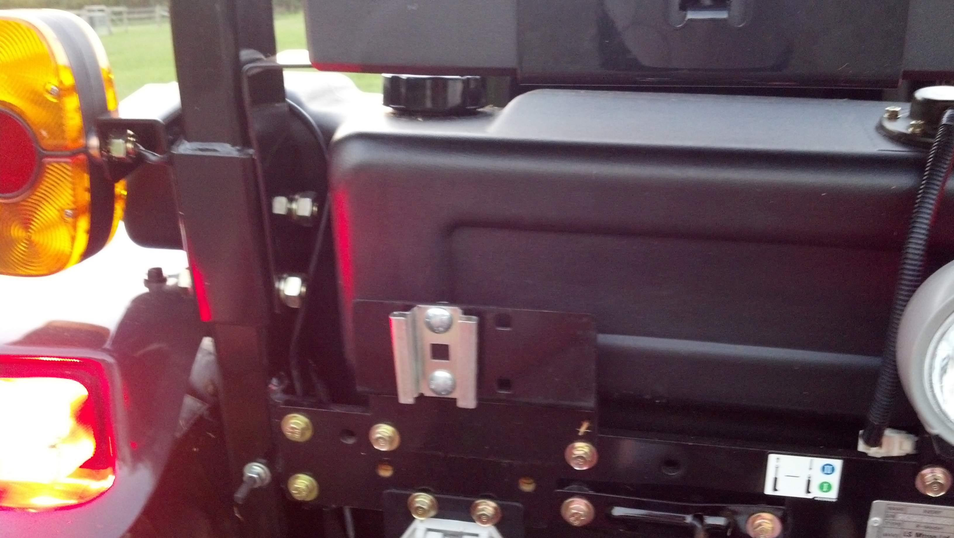

Took about 10 minutes to install. Just goes over the ROPS bolts then reinstall nuts. The toolbox has a slot in the back where a metal tab from the mount passes through. A small lynch pin holds the box on the mount. If you need to remove the box.. pull the pin and its off.

That's pretty slick! Did you mention that you can purchase the mounting kit separately? I could see getting the bracket, and mounting my own box.

Yes you can just get the bracket by itself. I didnt know how the kit was configured so I had to be the guinea pig and get both.. Im not sure the kit will fit a 3039 though. I know it will fit the 4041 and 4047.
   / NH B40 toolbox kit on LS R4041 pics #4
I'm going to take a look at mine this weekend. That bracket should be easy enough to fabricate. I'd like to get something like that on mine as well.
I'm also trying to figure out a place to put a chain box; that would be handy.
Either way, your setup up looks great. Nice to have a place for your gloves and a few tools! Enjoy!
