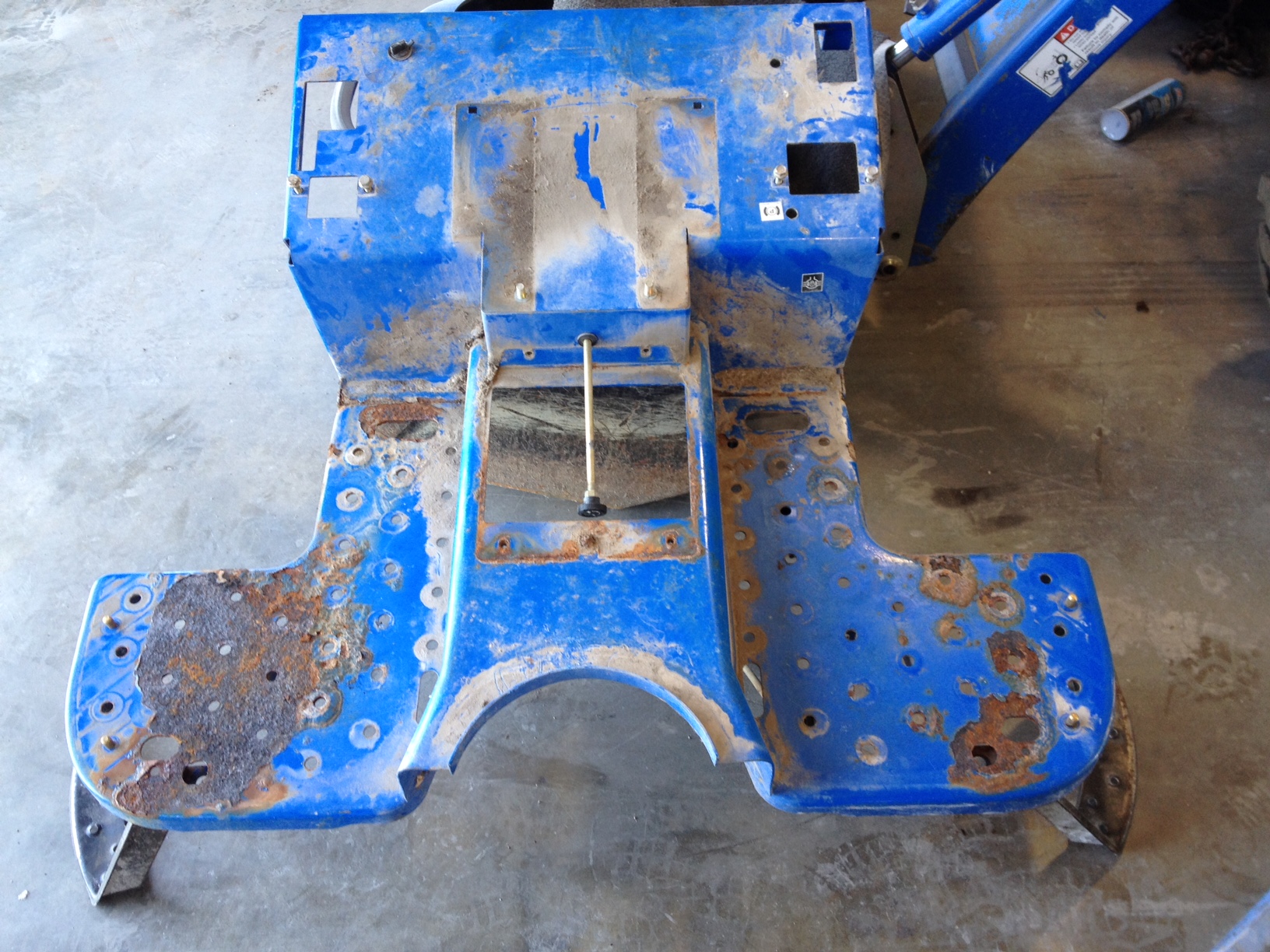

I have 2007 nh tc40da the platform is rusting under the paint. Has anybody else had this problem?

I have a 2005 that has major rust on the platform, the anti-vibration material under the mat keep the moisture in. The tractor is keep in the shed, the few time i had to leave it out it was covered with a tarp. I was shocked how bad it is IMG_4086.JPG
   / Nh platform rusting #4
Sandblast the entire platform, and then use TWO part epoxy primer, followed with TWO part epoxy paint.
If you can live with it, leave the entire anti-vibration/mat system off.
There must be salt where you have been using that machine.
