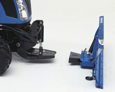

NH has a Quick-attach system. I know nothing about it. It looks proprietary; I suspect it will only work with NH implements. Just guessing.
They have a front mounted snow blower and snow plow that uses this Quick-attach system.
I am really asking two questions. Is the Quick-attach system a good idea and does it lock me into implements from only NH? And second, is it better to use non NH implements such as a snow plow and blower?

Doc Bob, with all due respect to everyone who has posted before me, I think they misunderstand you post.
While they are all correct that NH has a standarized skid steer QA system for their FEL, I believe your question is in reference to the Quick Attach system that is used for the NH front mount implmenets that are NOT mounted on the FEL arms.
If I understand your question correctly then let me state that the front implement QA system is proprietary and used for their Snow Blower, Rotary Broom, and front snow/gravel blade. It is also very very unlikely that you will find those implements as aftermarket implements that will fit on the front of your tractor. The QA system is available for the a wide range of TZ and TC Boomer tractors. The one TC that it may not (I simply don't know) be availabe for is the TC30. But I know the system works from everything up to at least the TC45 and possibly beyond that size. The attached photo shows the QA system on the front of a little TZ New Holland.
If I misunderstand your post and you want a REAR mounted Snow Blower, then you can buy any brand of 3pt blower, some are better some are worse but a 3pt hitch is a universal attachment system.
