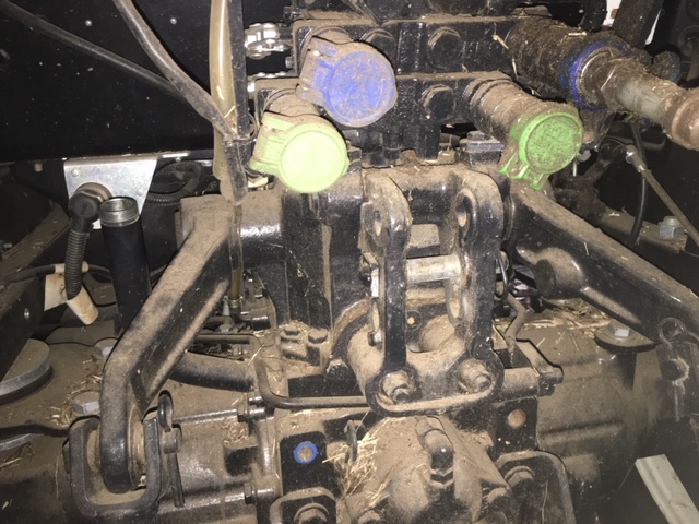

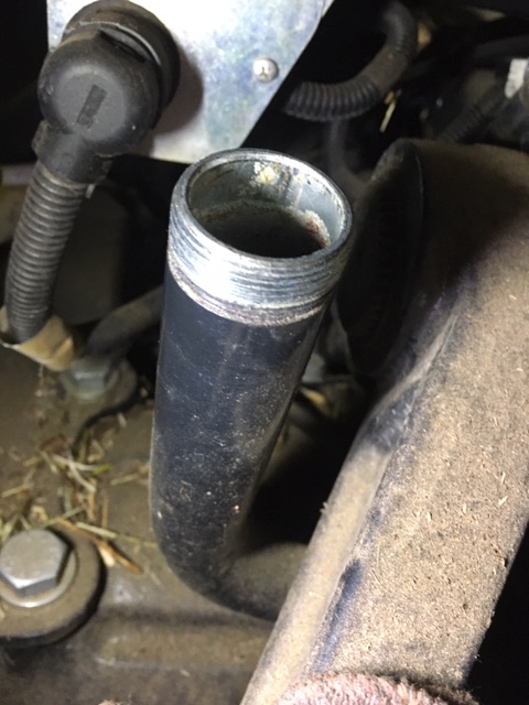

I have an implement that has 3 hydraulic lines.
1) Pressure
2) Return
3) Case drain line
So, I have a set of remotes to hook to for the pressure and return.
Does anyone know where the best spot is for a case drain line?
I have looked and it appears the fill spout is threaded, so I could go there, but wondering what others have done. And if I go to the fill spout for the drain hose, does anyone know the thread pattern? (See the photo)
Wasn't sure if there was another preferred location somewhere on the body, that was plugged.

Check your op manual and see if a zero pressure return location is specified, or:
Have your dealership service department check ASIST for an answer.
