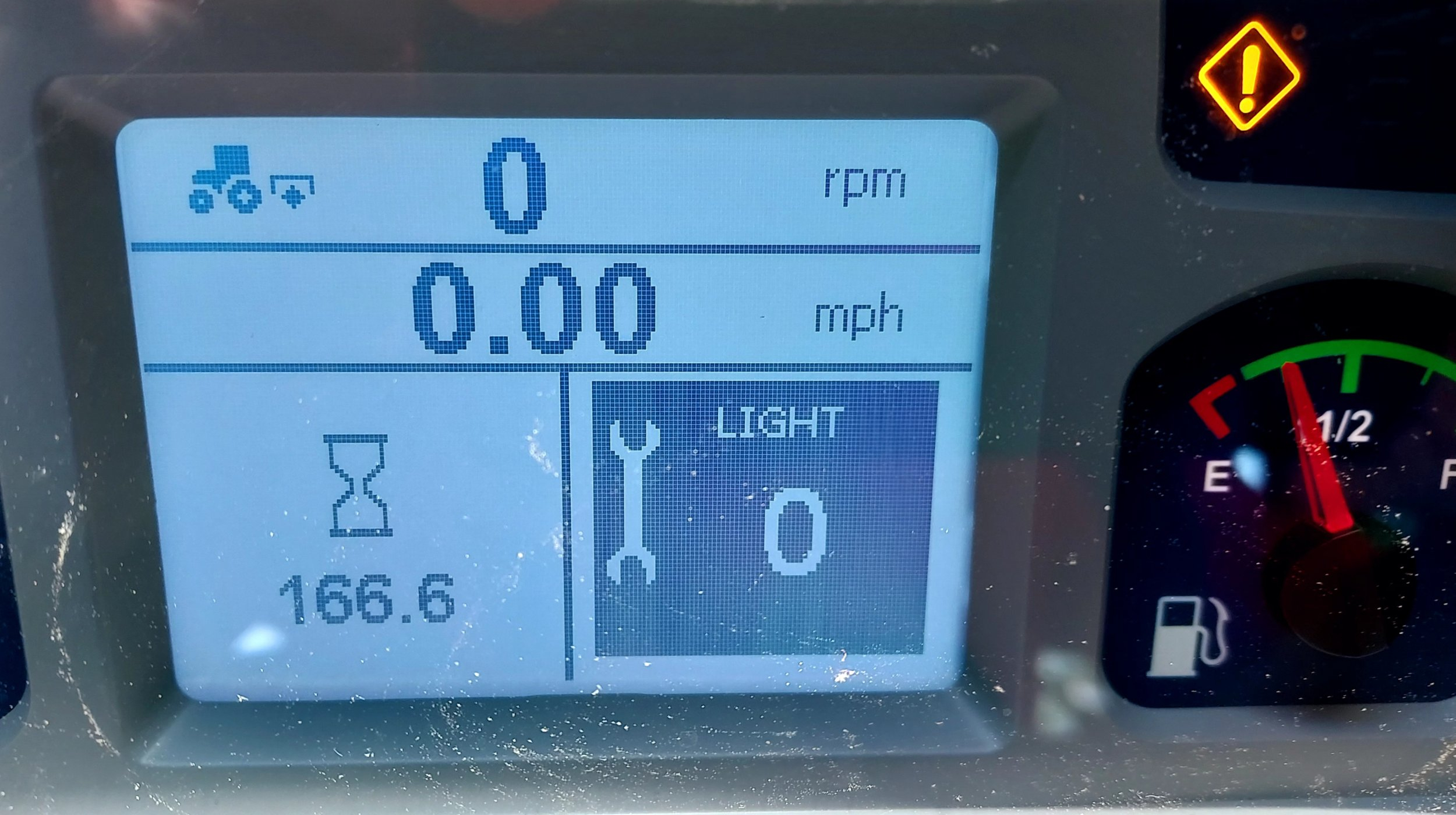

NH Workmaster 75 warning light
   / NH Workmaster 75 warning light #1
budlite
May 13, 2008
122
Toney, Alabama
NH Workmaster 75
Does anyone know what this means, manual does not define and dealer wasn't any help. Thanks
   / NH Workmaster 75 warning light #2
Its just a timer telling you Maintenance work is needed. Check in your Op Manual 3-34 "Programing Maintenance Work" You can follow directions there to reset it there using the switches on dash. This is where we use to reset it on our 4.75 should be the same.
