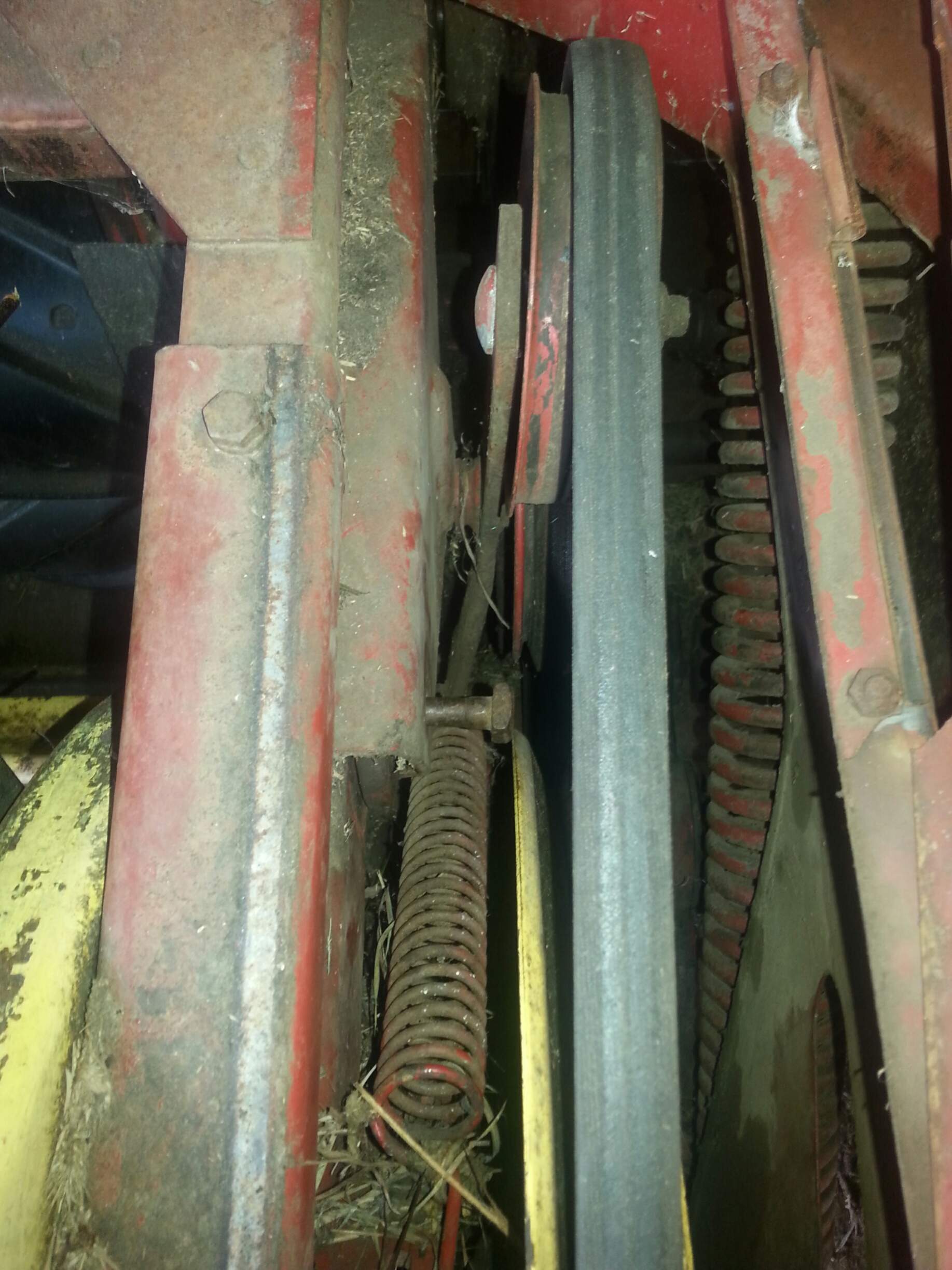

Never replied, it was bent knife seizing up - 8/17/15 - no floater spacer missing on one side, just not sure if bolt is required, can find spacer, but looks like zero room for bolt/nut?
   / NH489 Locked Up
CDennyRun, see attached, bolt I just placed in there to see if spacer will work helps somewhat, but still seems to be off 2-3 inches in height [too low] compared to left-hand side that has float bolt/spacer in tact - may have to tighten spring? I just don't see space for Bolt/Not, just the Spacer - there is no thru hole on the cutting side of the float, spacer can only be slid in from the right side it seems - there is a hole further back, but there doesn't seem to be enough movement/travel to reach back that far - hope this makes sense - see attached

CDennyRun, Messick's to the rescue as always - there is a bolt/nut/spacer that will allow float to be repaired, not just the spacer - spoke with Les in Service @ Messick's, explained how to get at it and how to adjust spring, parts arrive tomorrow a.m. UPS RED, hopefully will be cutting hay by 2pm if all goes well!
