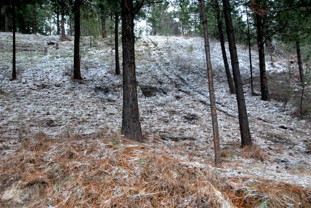

Same thing happened to me last April on this slope (just before the snow). If there were front brakes, I could have controlled the decent better while not knowing it wasn't in 4x4 until reaching bottom. This is one reason I really like the AWD function of the X749 for the steep hills. With that mower, it will never be in 2WD. On the 2530, 4WD low range is fine. He expected that, but it wasn't. I expected mine in 4 low range also, but forgot just before cresting the hill. You don't easily analyze the problem and fix it in the seconds you realize you have a problem. I was more concerned about getting it down straight and not as fast as possible. If one can forget, it will likely at some time be in 2wd when you want or need it in 4wd.

   / No 4-wheel brakes in 2WD on 2520 #8
Larry,
In your post were you refering to the front wheels braking by locking up with the rears due to mechanical 4 wheel drive and/or the rear brakes slowing the front drive shaft?
I don't know if I would lower my FEL to slow down as a front brake because what if it grabbed?
   / No 4-wheel brakes in 2WD on 2520 #9
then you would STOP, but maybe wreck too! :)
