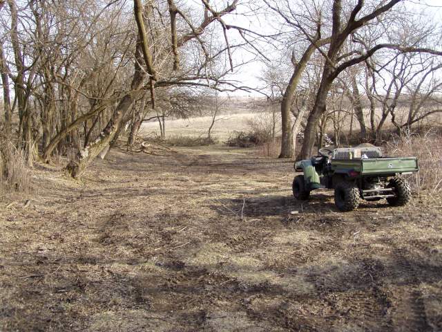

SD-Dave,
Given the longer wheelbase and much larger tires on my Ag tractor I don't believe the Toolcat will ride smoother over rough ground. With that said, I will be using the Toolcat in the same areas that the Ag tractor was used. It's hard to judge how the speed will compare until I have done it a fews times. That will be happening over the coming months.
We have similar conditions here, roads are posted and we received enough moisture that you pay attention to where you are going. Attached is a pic of one of the areas I have been cleaning up so I can get thru with the Toolcat to mow. The HPX Gator leaves tire prints in it while the Toolcat leaves up to a couple inch depressions. The Ag tractor would leave some nice R1 imprints and nice divots from the front tires when turning. Normally in these conditions I would not bring the Ag tractor in this area while it is still wet. I've been all over it with the Toolcat but I will have some cleanup from the small ruts. What damage there is was caused by ground pressure not turning. It will spin right around on sod and leave little, if any, marks.
The maneuverability, versatility and operation of the Toolcat is what really makes it stand out. It's a kick to work with.

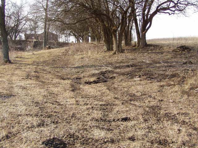

Another pic .....
