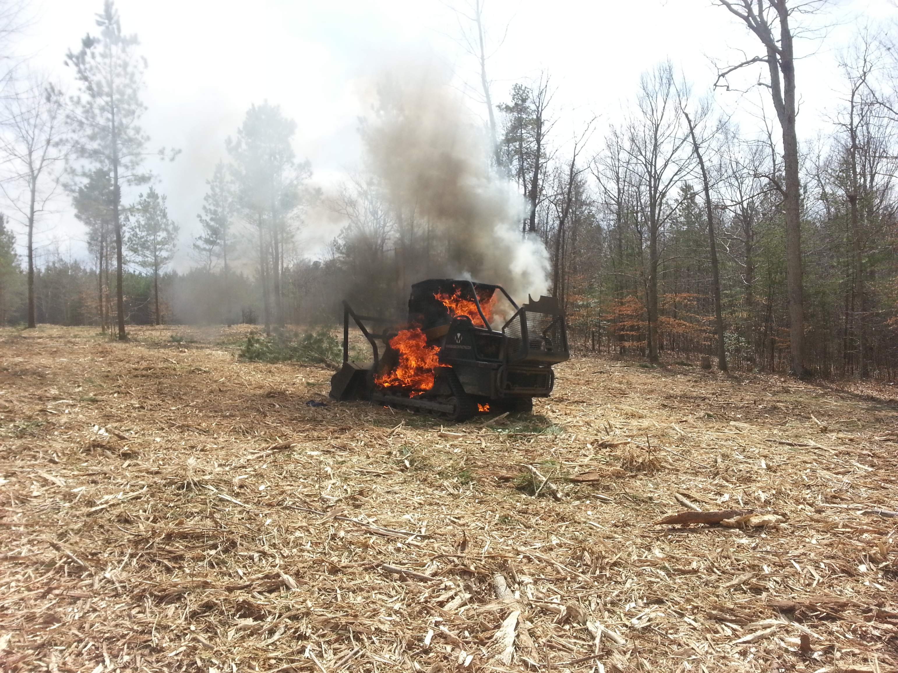

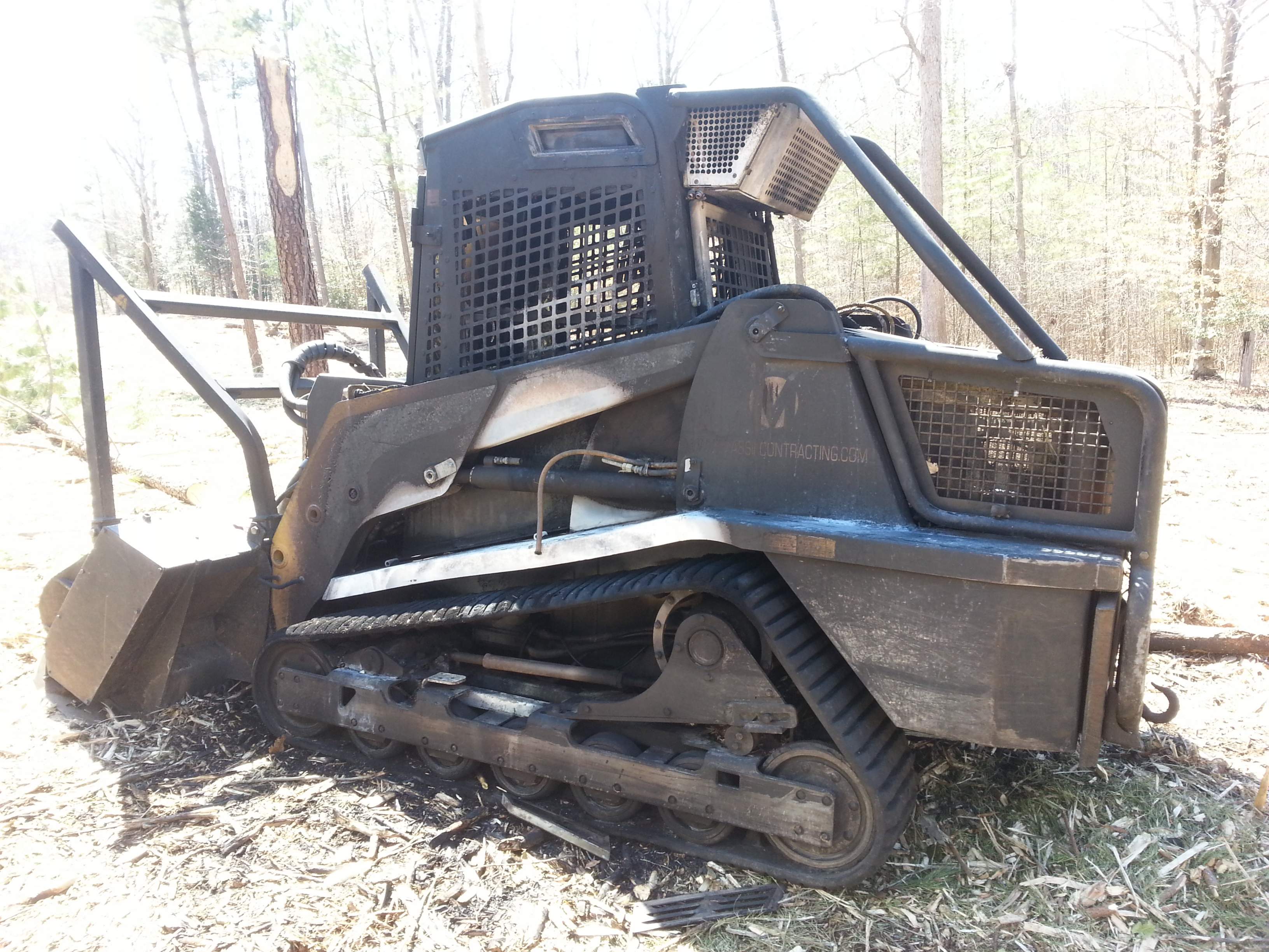

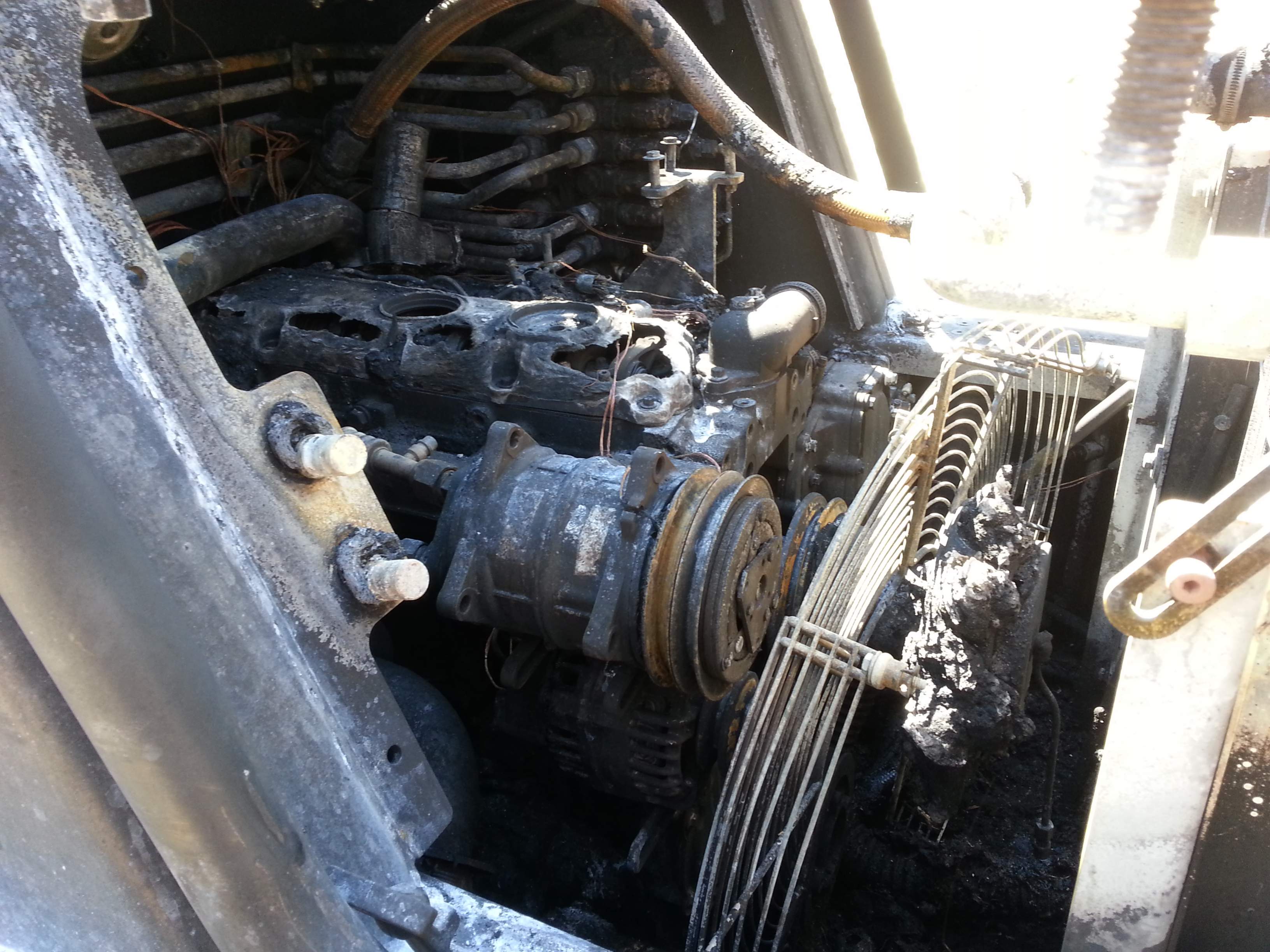

it was my last 30 minutes of running on a 4 acre job.....caused by debris in the engine compartment (which we clean out CONSTANTLY), coupled with a windy dry spell, ignited by the exhaust pipe, with the reversing fan fueling the flames! the "stock" fire extinguisher was no match, although it only started as very small ember that barely made any smoke. after a few five gallon buckets of water i ran down through the woods, i quickly realized she was done. the fire department had to take care of the rest. luckily they were able to drive the brush truck to the site (three different times!). i ditched it in the middle of the field knowing it could turn bad quickly, which ended up being a great move because otherwise half the county would still be burning. the mulcher head survived at least.
now i need to find a way to drag that sucker out of the woods to where the winch truck can take it.
