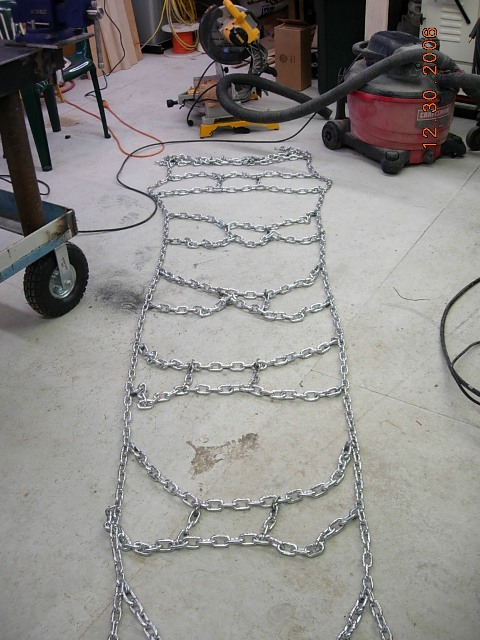

there are no tire chains in CO. !!
So whats a guy to do? Search and Search.
No one has anything. No car chains or tractor. Even hard to get snow shovels. so what did I do?
Make your own. Run to lowes and get 2 50' boxes of 5/16 HT and 1/4 HT chain, some 1/4 repair links come home cut with bolt cutter and weld!! I will post some pics.
Has anyone ever made tire chains?

I made a set for my brothers pedal tractor about 40 years ago. Did you make a set for the fronts or rears or both?
   / No chains in Colorado so......

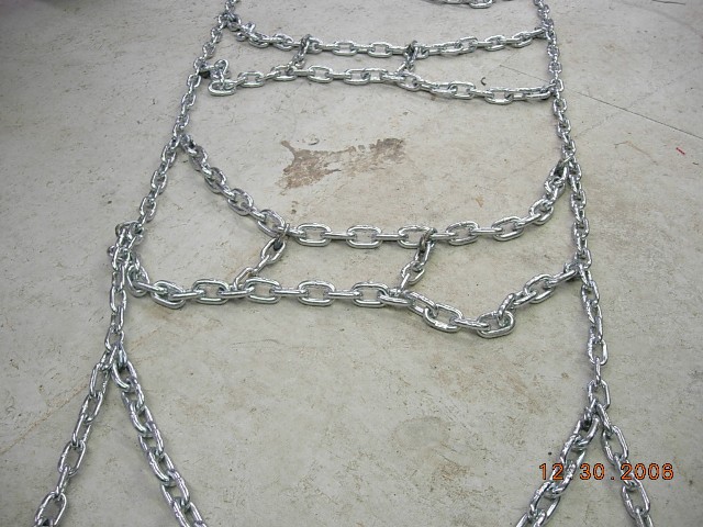

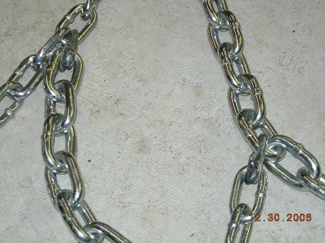

Just rears so far. I welded the links where I put them together.
Here are some pics.

Thanks for sharing the pics,and now I understand when you wrote weld...be interesting to see what rear set of chains as you made would cost over the counter.
   / No chains in Colorado so...... #8
Lynkage,
How did you ever get the dimensions to start the project? Did you measure up the rears or ghave specs from somewhere?
#9
johnk said:
Lynkage,
I just measured the tire and then when I had a radius that I liked, I mesured from there over the tire to the otherside. :confused: :eek: :D
   / No chains in Colorado so...... #10
Great idea lynkage...and what a money saver. Any idea how long the whole project took?
