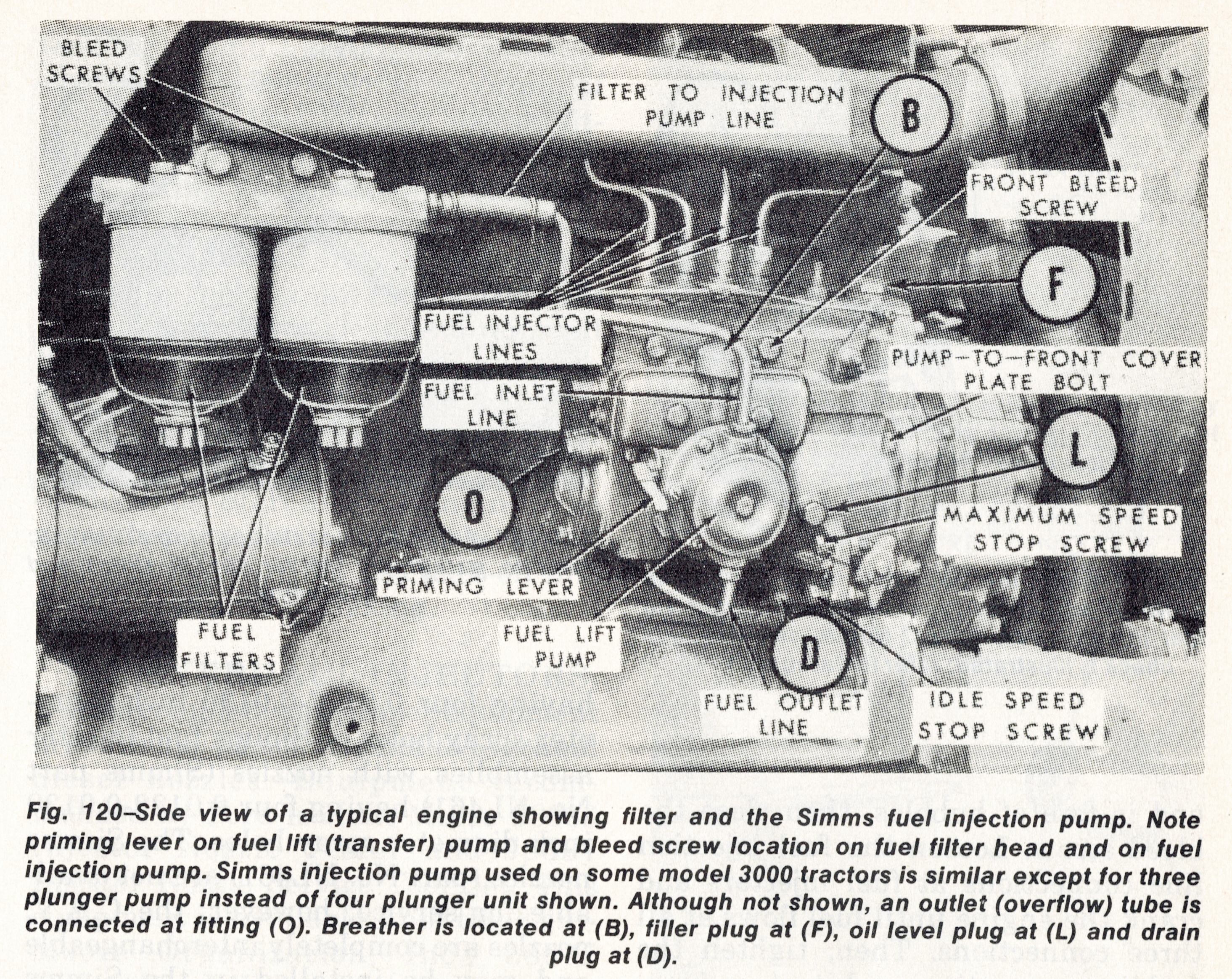

I'd like to throw out some more things I have done, to see if y'all still think it is the injector pump.
Trying easy stuff first: I was thinking low fuel flow. I took the line off after the lift pump. Cranking the engine produced about a tablespoon a second, which I assume was good. I reattached it, and took the line off after the fuel filters. The same amount came out (so I figure I didn't have clogged filters).
That, of course, caused the lines to bleed, and I had to get the air out up to the injectors. Once done, the engine started again. The throttle response is really slow, and only comes up to maybe 900 RPM. About 1/2 throttle produces idle speed, and if I close the throttle more, the engine winds down and dies. I can also force the engine off at any time by pulling the 'stop' lever.
The tractor must have the Simms system, as it looks like this photo.
Is the side cover the one behind the breather vent?
Please tell me if I should try draining the pump and putting in ATF to free it up.

The breather is attached to the side cover.. take off the 2, 1/2" screws & pry the cover off.. I'll bet it looks like baby poop in there. Lol
Just move the control rack back & forth.. spray your favorite cleaner inside & drain the oil/mess from the bottom screw..
Keep doing that until its clean.. THEN fill w/ ATF & actetone & let it sit a week..

I took the drain plug out of the injection pump. What ran out looked, and smelled, like what would be in the gas tank of a car sitting in a junk yard for 40 years. It was a very thin oil, and stunk bad. I took the side cover off and found the breather to be all clogged up. Cleaned it. Pushed the rack back and forth - it didn't seem to be hung up. I then observed this is the part that is moved by the stop lever. (I expected it to move with the throttle control.) So, not seeing anything obvious, I did what PumpGuy said (or as closely as I could). I put a pint of acetone, and because I didn't have the ATF that I thought I had on the shelf, I topped it off with 5W-40 motor oil. I was going to turn it over a few times, but forgot to pull the stop lever. I hit the key and it roared to life. Encouraged, I pulled the throttle and it quickly revved to full speed. I pushed it back to the idle position, and it IDLED. It didn't die!
I ran it about 10 minutes. Throttle response was quick and smooth. Next time I go over to the B-I-L's house, I will drain the pump and put the straight oil (per the manual) in it, unless you recommend anything else.
