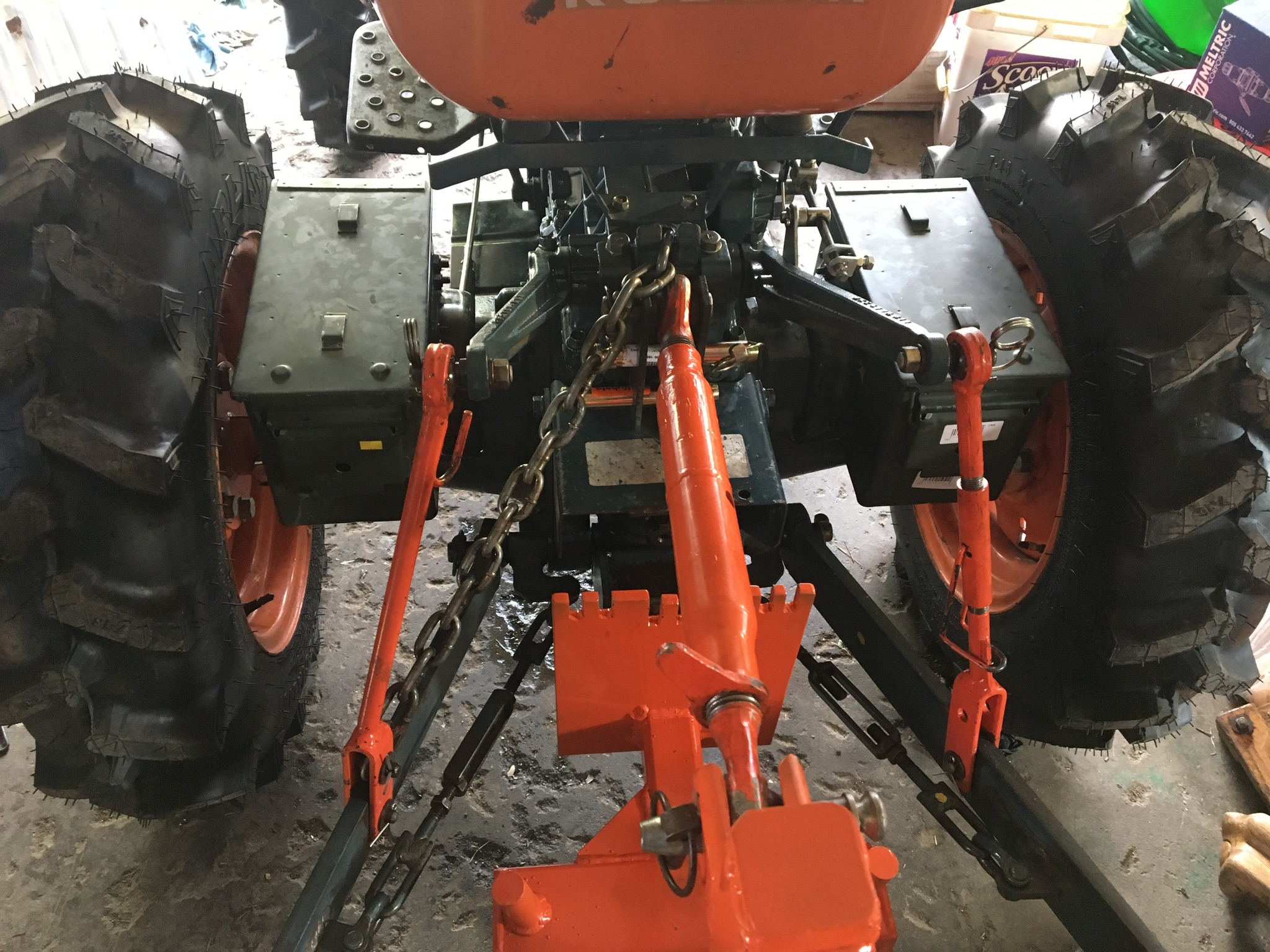

This setup is on my B6100DP KUBOTA. It didnt have fenders when I bought it so I used the mount holes to install sealed Ammo can fenders and storage for tools and stuff.

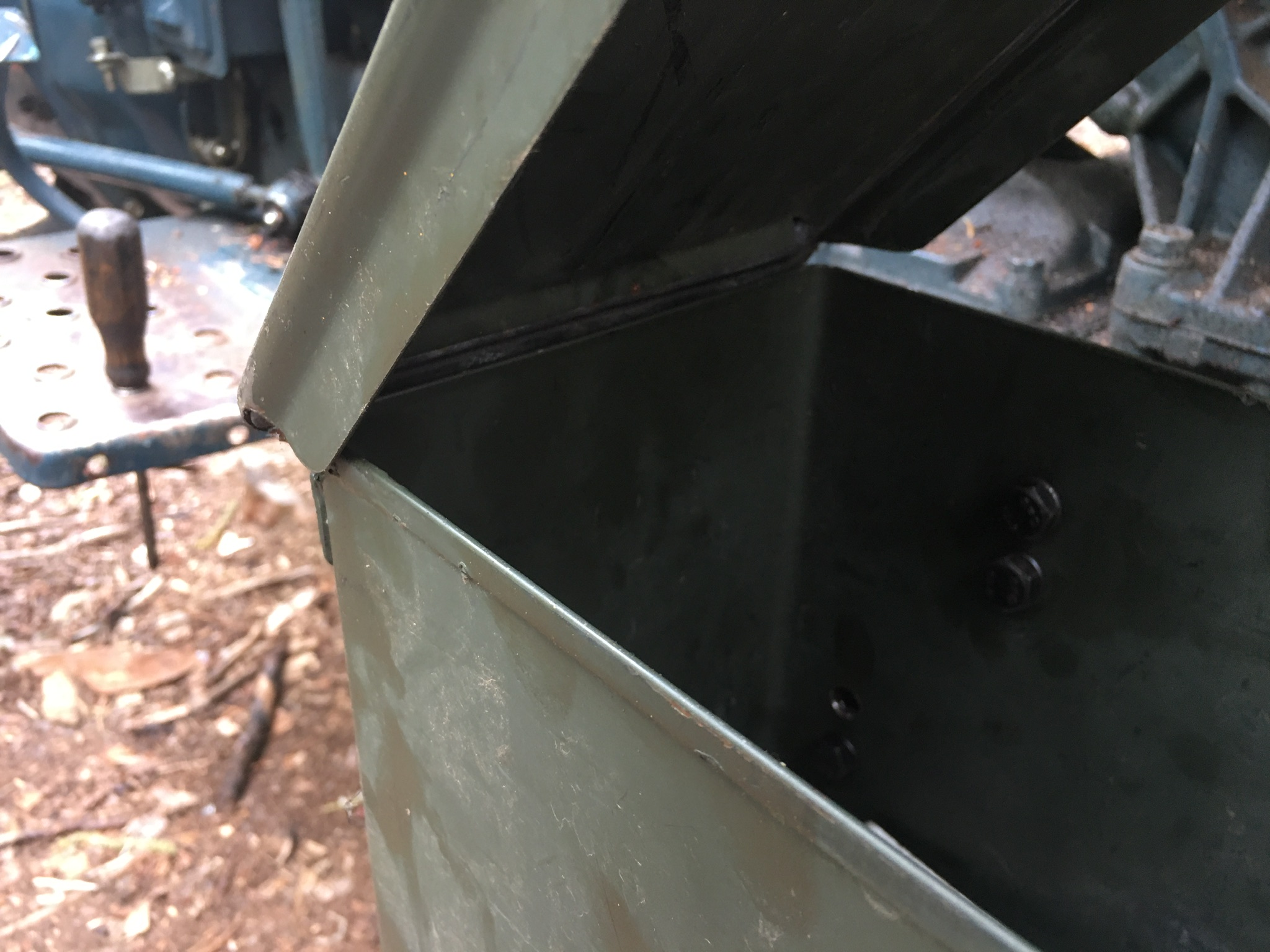

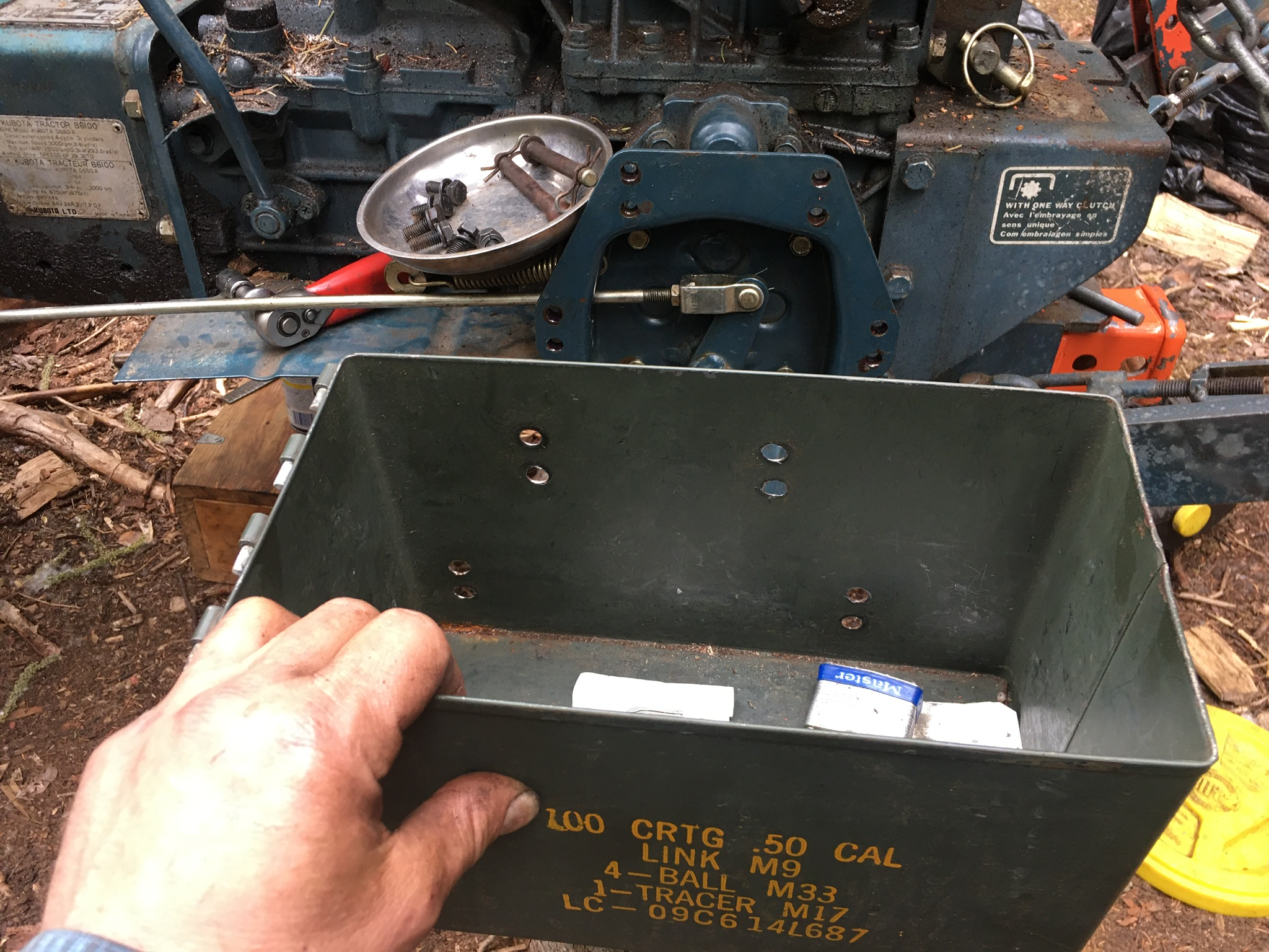

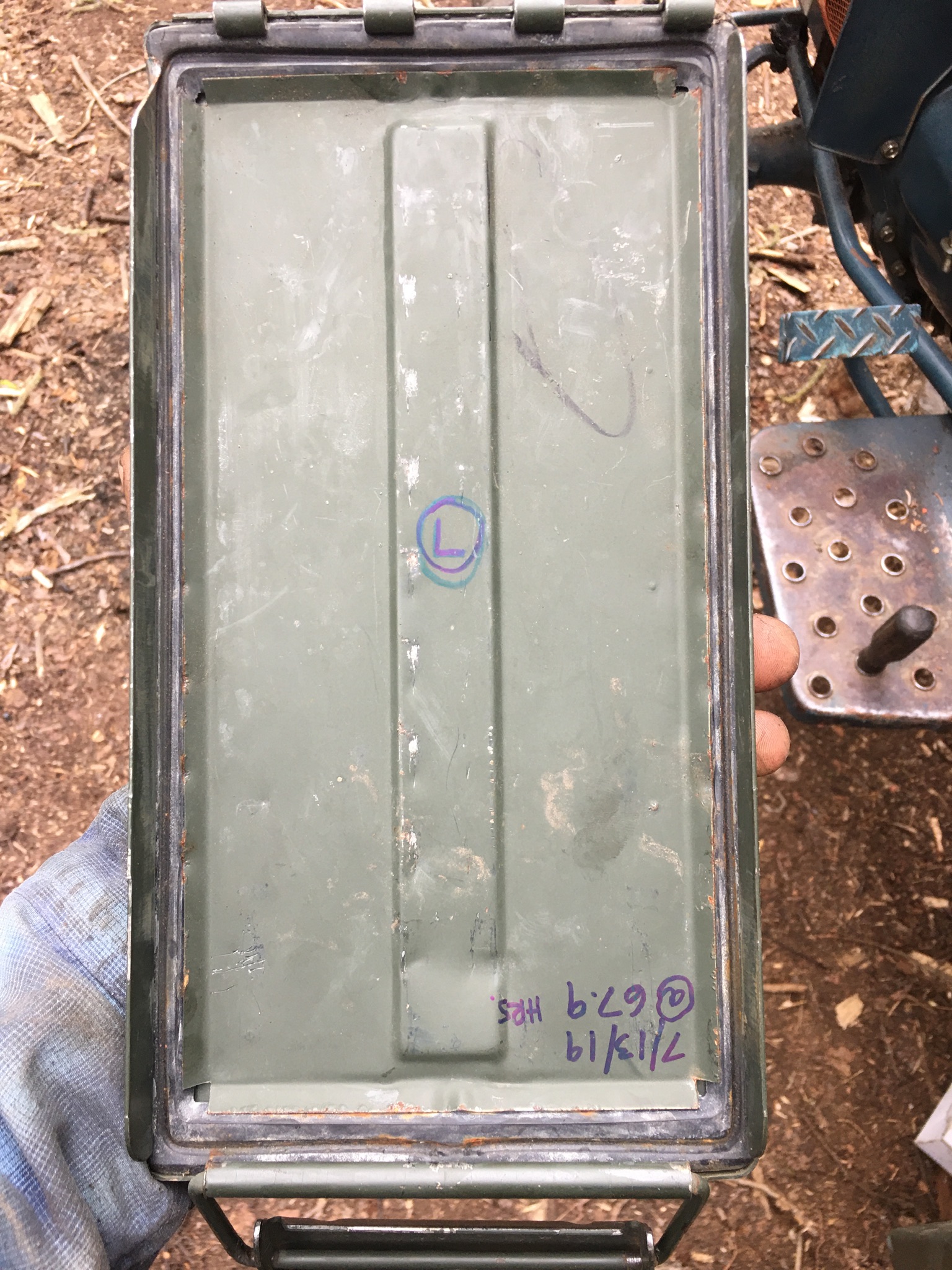

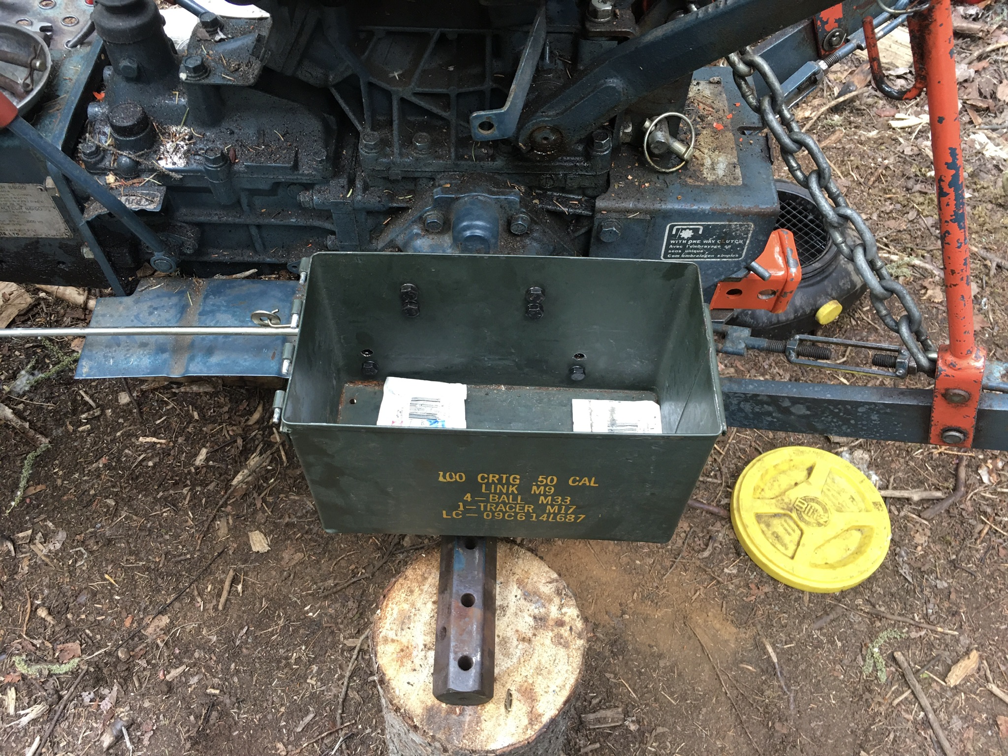

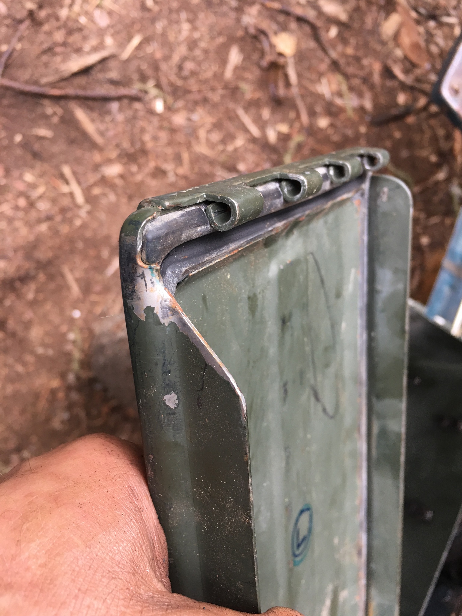

You can see in the pics that I cut the edge from one corner of the hinged edge so that I could slip the lids on or off right there without moving the seat at all. The lite trimming doesnt interfere with the nice weatherproof rubber seal of those 50 cal cans either:) I did drill a 3/8 inch whole in each inside corner for drainage just in case.
The boxes are great to carry chains, water bottles, tools and all sorts of things and when it痴 dry outside just side slide them off and they are open top storage to make it easy access. I use these things constantly and theyve never got in the way and are substantially smaller than fenders. Theyre small but Ive never been splashed with mud but I dont go fast either lol.

I am wondering does it sling mud all over the place with no fenders ?

I dont haul ***** lol
