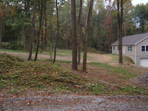

Anyhoo, some pics of the work I need to do first.
That is the front yard, the brown area is the swale. it has been full of water at times which is why I want to divert some the other way. The pipe from across the road emptys to the left and behind the camera.
BTW, that mound in the woods about center in the picture is my yard /forums/images/graemlins/grin.gif soon.

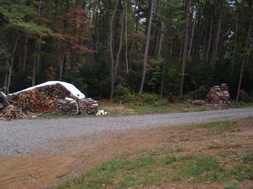

This one is of the woodpile. The upper right side is where I am going to run the culvert through the drive. Just above the little pile. For referance that is a split stacked cord on the pallets. The main pile is 8 ranck deep. 30-35 feet long and 9+ feet high /forums/images/graemlins/grin.gif

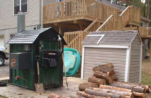

Here is a shot of the Woodburner, the shed next to it is the oil tank. the flashing on the roof is access to the fill. there is another on the oppisite side to get to the hand pump for tractor fuel. The pine logs are where I lay a ready supply for the stove. I just put it on the concrete last year and could get about 3 days worth stacked. This should hold at least a week, more if I go on the concrete.

How does your wood burner deliver heat to the house? I've seen a modern wood-burning unit in a house. In that case, the heat is directed up to a thermostat controlled fan, which distributes the head to a few overhead vents throughout the house.
   / No Mahindra yet, or Paperwork delay grrrrrr
#9
Dax, its a "boiler" in quotes because it doesnt actually boil the water.
Ok, here goes.
There is a water jacket in the burner itself. the water is heated by the wood in the firebox. he draft is what controls the temp of the water. The draft opens at 180 deg and closes at 190. This is a dual fuel system and if the draft opens and the wood is not making enough heat, a fuel oil burner cuts in at 158 deg. Makes starting the thing nice /forums/images/graemlins/grin.gif
The water is circulated into the house by pipes underground and fed into copper manifolds. I have 3 zones. The garage and the basement zones are radient heat in the concrete floor. The upstairs zone is forced hot air.
When the basement or garage thermostat calls for heat, valves open on the manifold and send hot water into the radient tubing.
The upstair is a different setup. I wanted the option to add AC later with a minimum of hassle. Since the basement will be finished and the garage will also, I opted to get my ducts in at the start. The heat exchanger is pretty much like a radiator. When the upstairs zone calls for heat, the only thing that happens is the fan kicks on.
The water is also plumbed to a heat exchanger for the hot water tank with a mixing valve on top of the tank.
