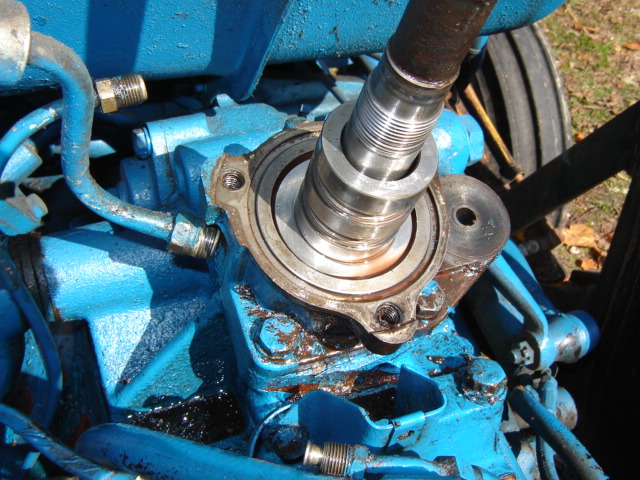

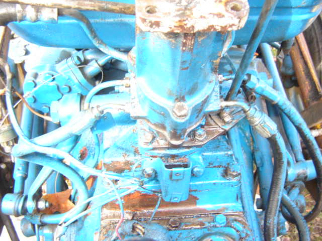

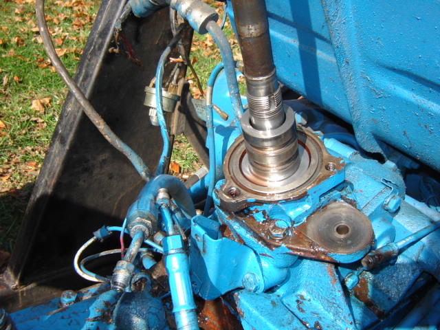

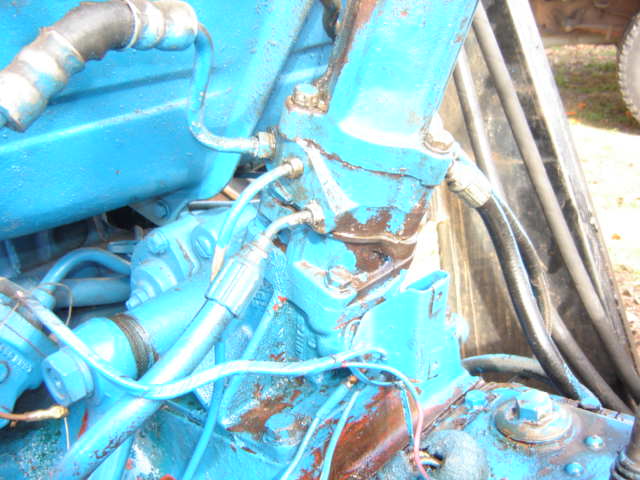

No power steering after Replacing a seal in steering column ?

   / No power steering after Replacing a seal in steering column ? #2
you MUST have gottent he springs and balls back in 100% correctly.
user whodat, Ultradog or rickb can help with the PS balls.
otherwise.. if you DID get them in correctly.. you may simply need to keep filling and turning wheel lock to lock to get air out.
Thanks for trying to help me. I wanted to let you know I found a guy who who straighted things out for me , I left a post for anyone else who may have the same problem.
Sincerely,
Duke
