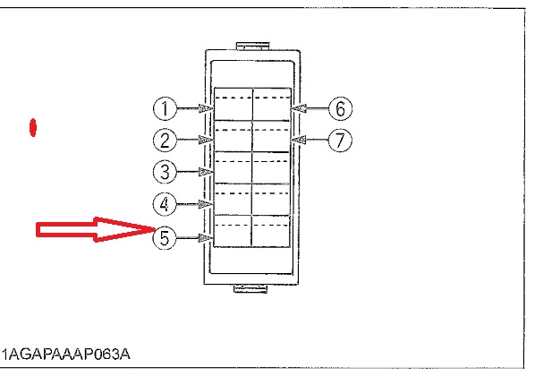

Study the page I have attached. You likely have an Operator Presence Control on your tractor and it is intimately involved in when the engine can run.
Seat switches are a common issue.
Dave M7040

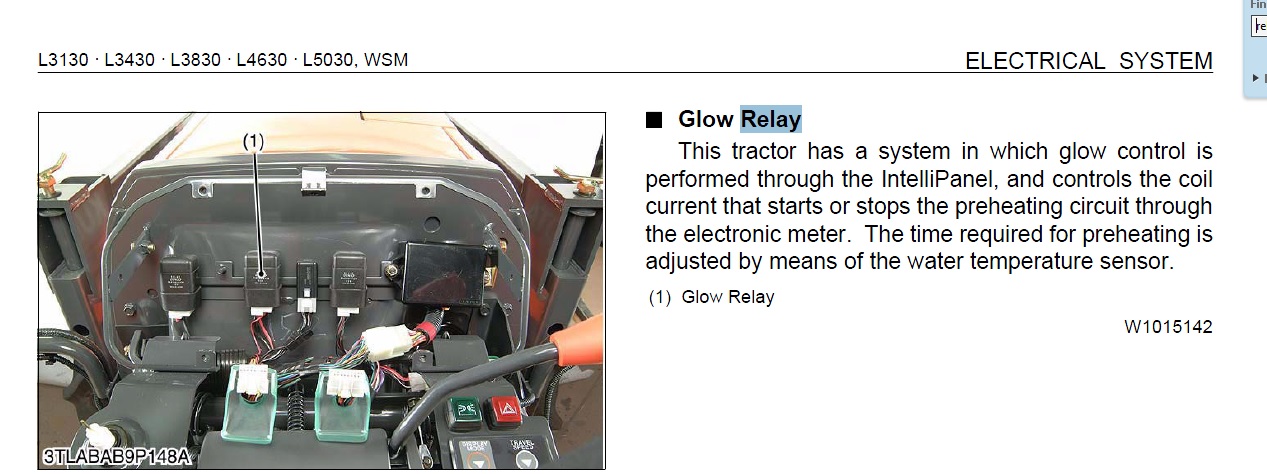

Can you tell me where the relay for the fuel control is located, I don.t eve know what it looks like?
   / no power to fuel control solenoid on l3400 #7
I have attached a picture I found showing where the Glow Plug relay is located. Likely the Engine Stop relay is one of the ones beside the Glow relay but I cannot say for certain.
I think you have to remove the dash or Intellipanel to get to the relays so you may want to consider getting help from someone familiar with these tractors as you could easily turn a small problem into a much bigger one.
Dave M7040
Dave M7040
Thanks, I believe you're right. I'm going to call local tractor mechanic. Your help is greatly appreciated.
