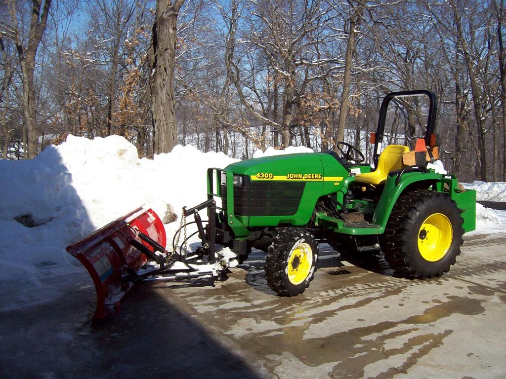

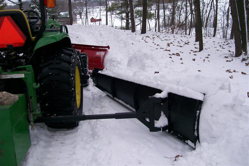

I agree with others, that your truck with blade would be the way to go. If you have other tractor work, and need a FEL, that is another option.
My solution is this Western blade with a side wing to push snow further "over the edge".
