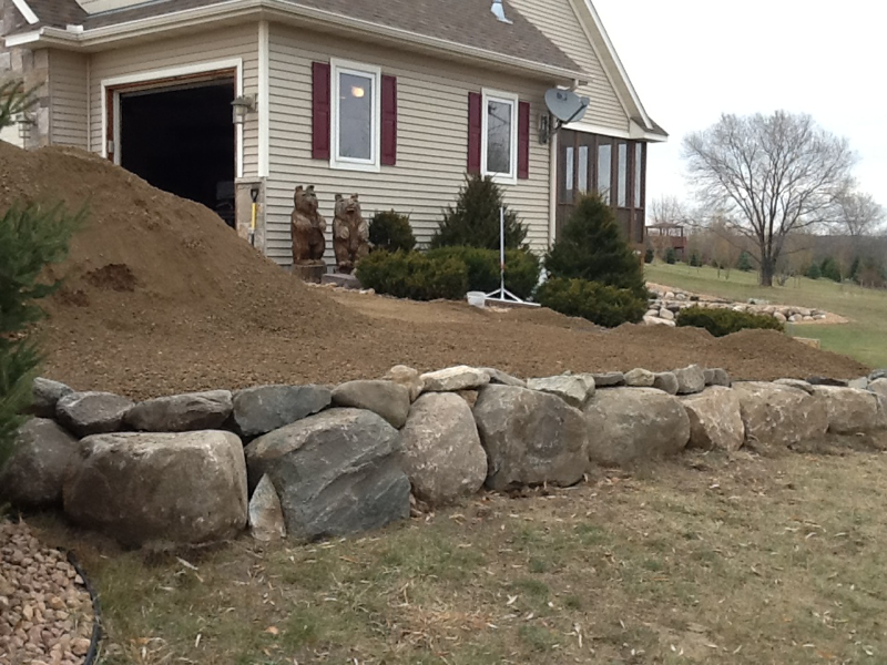

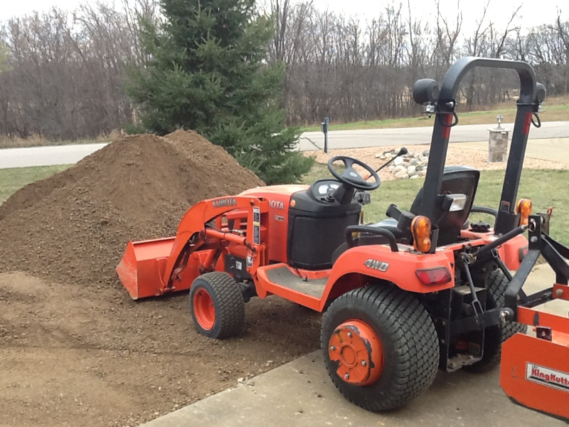

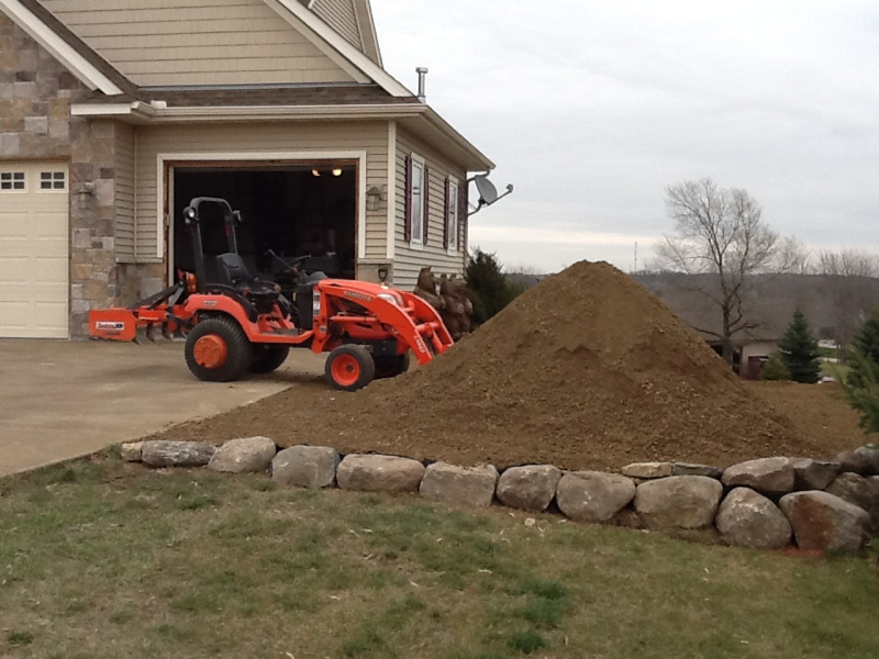

Thanks, I' m in the middle of building a parking pad. 6 tons of boulders and 19 tons do class 5
