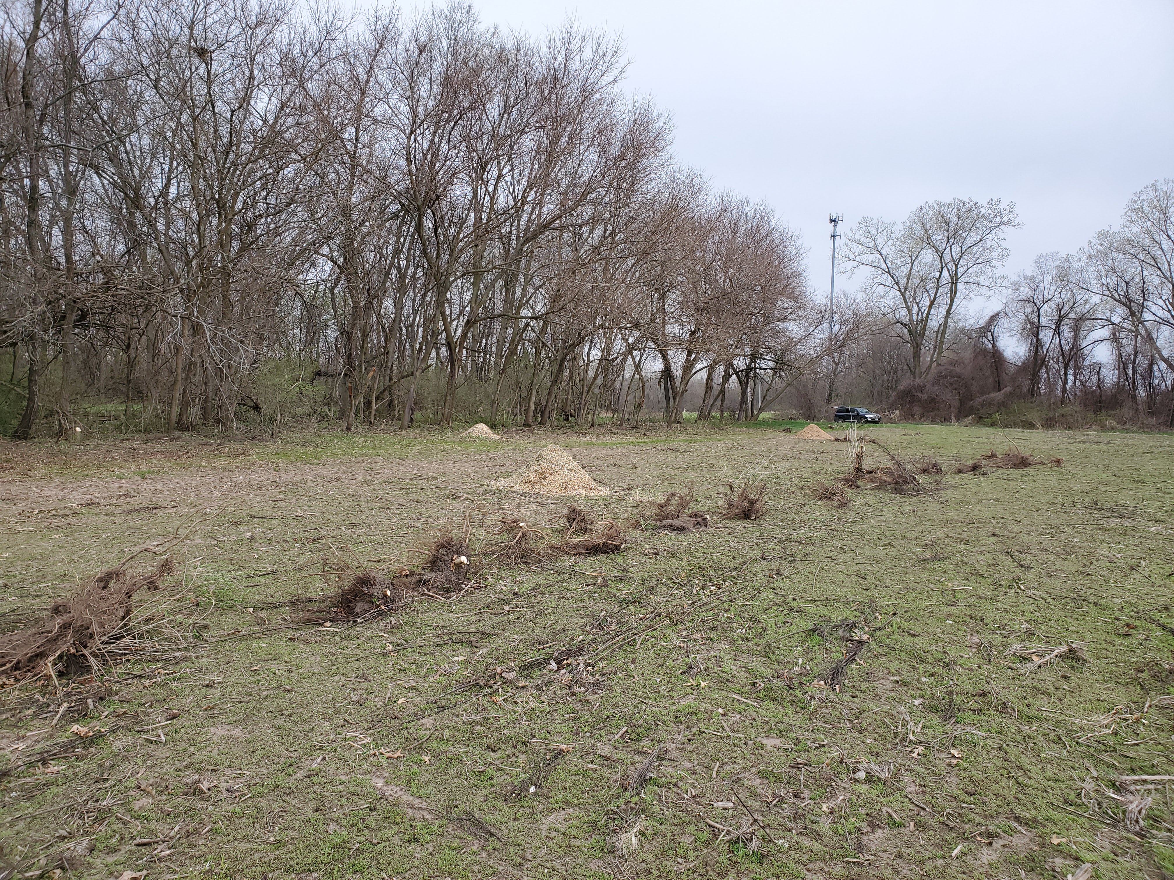

I spent several hours this morning chipping small trees I pulled from the ground around my field. After cutting off the root balls, I could chip the whole trees. As I was about done, I noticed the chute became clogged -- packed full of chips. I drove back to my barn, removed the chute and cleared what I could from inside the chipper. I started it up again to blow out what remained inside. At this point, I noticed the drive shaft shear bolt was sheared. I imagine this happened earlier when the chute first became clogged. Or perhaps these two incidents are a result of another problem??
After replacing the shear bolt, I started the chipper again and the flywheel was rotating and I could hear the debris inside the chipper swishing around but it didn't emerge from the chute. I fed it a branch and it chipped it okay but nothing came out the chute.
Any ideas what's going on?
Root Balls and Wood Chips
