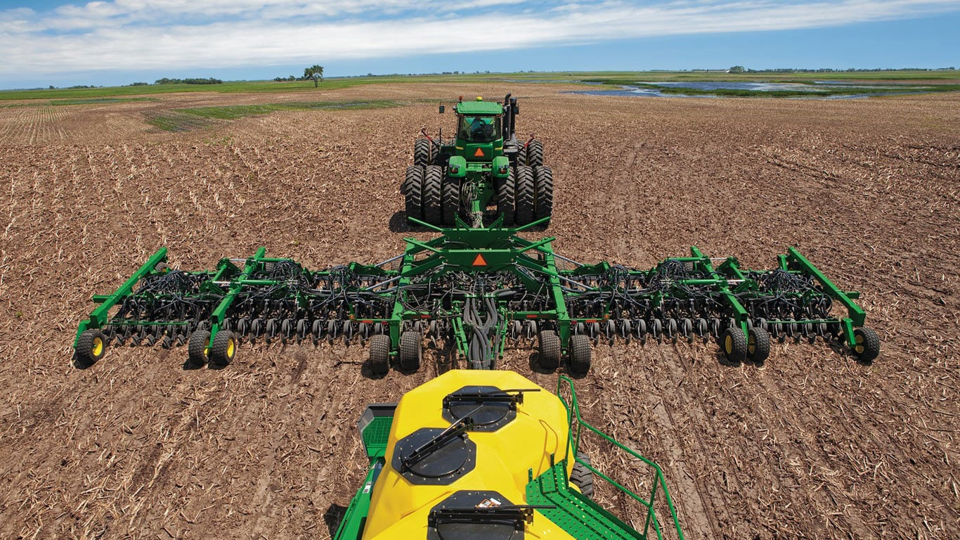

My family members run no till drills, just a tad larger. ;)
1890_no_till_air_drill_field_standard_r4d003253_large_4306a8dbd7647734661da6a0adc459fccf65a1d2.jpg
/ No till drill #12
Maybe I should quit horsing around and buy a setup like that.
