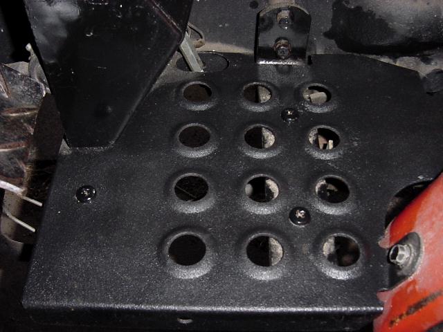

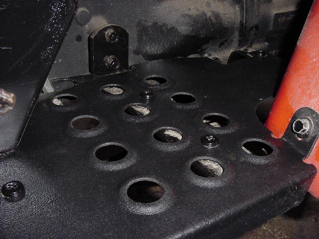

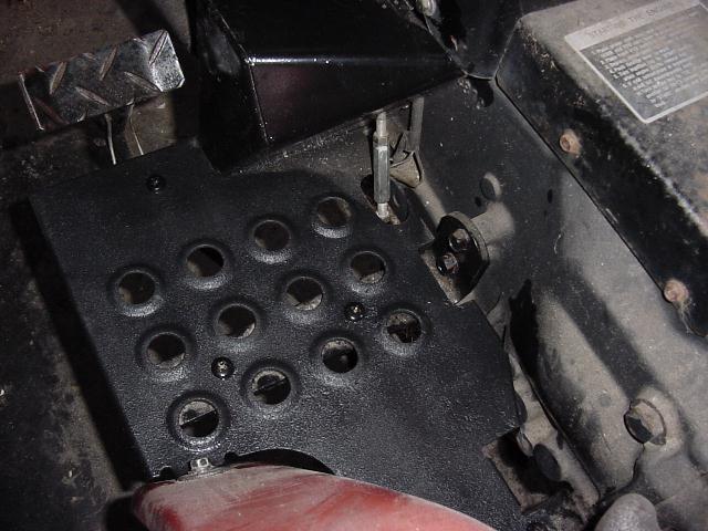

Hey guy's:
While I was buzzing around Sunday morning took the digi camera out and poped a couple of shots so you can get a visual of what the spray on stuff looks like, got to thinking if I would have lightly sprinkled some asphalt, concrete powder or sand in it before it dryed it would probley even come out more sure footed....hummm always think of a better mouse trap when I'm done go figure. I tryed to show on the pic's that it does have some texture to it anyway
Whiskey
