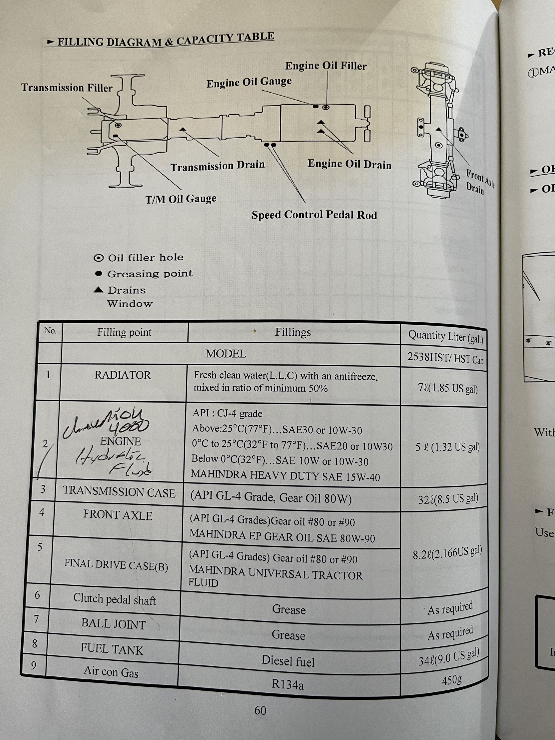

It’s definitely a HST, but I’m sure I have the right manual

Everything in the manual is GL-4, but all I saw at the local TSC was GL-5, I have a Deere dealer available also - I need transmission/hydraulic oil since the sight bubble is showing low and I still have a couple tons of gabion stone to move.

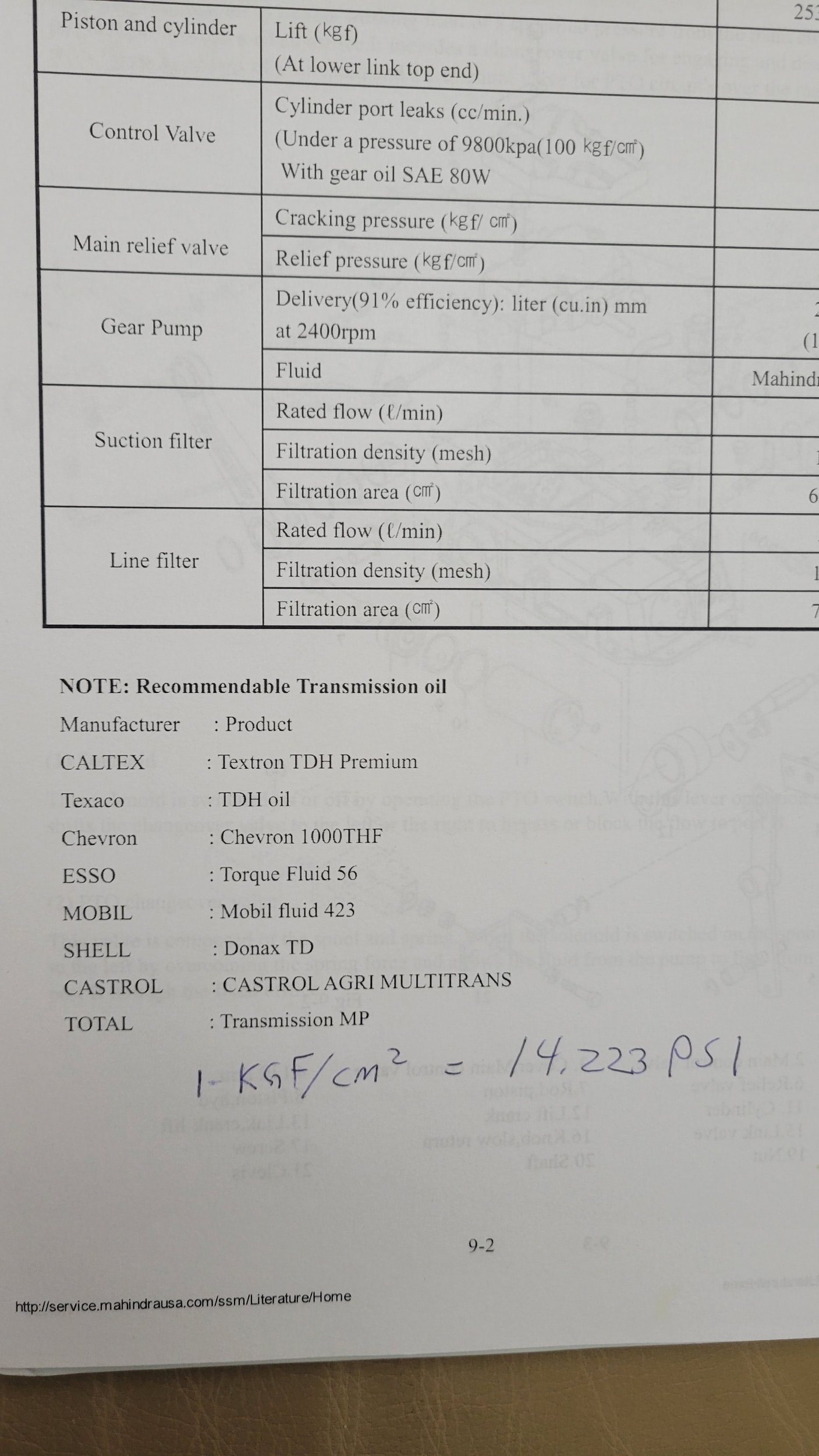

Here is a page from the 2538 service manual, please check with a Mahindra dealer before putting gear oil in your transmission.
