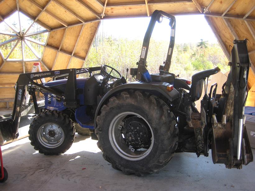

Hi Grp: New owner of used (2000yr/700 hrs) Landtrac 360DTC w/FEL and BH - trying to rehab a not worked for 60 yrs farm on a wooded 100 acres in East Grand Lake region of Maine (Washington/Aroostick county line).
Just got barn closed in (40' geodesic dome) and am finally getting to work with the tractor which I bought a month ago. Moving stuff around - stopped, turned tractor off and it wouldn't restart - not even a click. No warning and it had restarted at least 3 dozen times since I owned it, including 3 times just before this event.
Went right to battery and discovered mickey mouse positive terminal repair which had failed. Re did in a better fashion, still no turn over though I had dash lights. Charged and tried jumping - charger showing draw but motor not turning over. I can turn motor over by hand using pressure on belt method. Got cold, came in and found your forum. Any (and thanks for!) ideas?

Sounds like the ground is bad.
   / Northern Down East Maine Checking in w/starting issue #4
Yep,If it wont even click,find the where the starter grounds on the frame.Welcome MAINER ,iM IN THE FARMINGTON area.
ALAN
Sorry to be so long in getting back - my problem turned out to be a bad ground. I thought I had checked all ground connections and everything seemed good so pulled the ignition and bench tested it w/continuity tester - all good - really puzzled at that point - went back through everything and found problem - over 2 hours after I should have.
