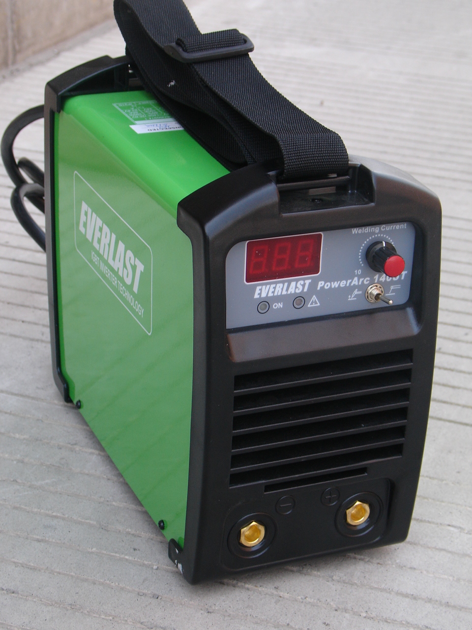

Those of course are chinese transformer welders. I could sell them all day long for that price, because they cost almost nothing :laughing: But they should be ok. There's any number of companies producing the exact same model or similar unit. Some are super high quality, while some are very low. IF northern is selling it, then it should be in the midrange. But IF you are looking for cheap amps, we have a brand new unit: The PowerArc 140 ST 110/220 with good performance specs for just a little more than that.
