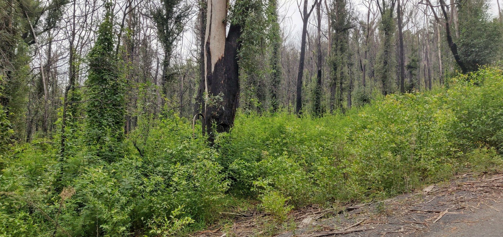

I'm in SE NSW, Australia on 50 acres of forest on a sloping block (with grade ranging from flat to vertical cliffs, I'll only handle sections that are of a modest/safe grade) with plenty of rocks and boulders. I lost my tractor in a bushfire and am looking to replace it. I want to remove boulders and rocks, clear trees, grade sections into small paddocks, grade driveways and tracks and in the medium-long term have a larger portion of the property that is cleared and can be maintained with just a slasher without having to be on the constant look out for rocks.
I have been looking at ~50hp tractors with backhoe/grader/heavy duty slasher attachments for these tasks. An alternative method I'm thinking about is getting contractors in with dozers etc and then just getting a smaller tractor for maintenance once it is cleared, I'm hoping to clear around 15 acres out of the 50. The property is my home, not (currently) being used as a source of income.
My question to you is, what would you choose to accomplish these tasks?

Having your heavy duty clearing done by a bulldozer crew is likely to be cheaper than the wear-and-tear you will put on a new tractor and much, much faster. However, I doubt bulldozer clearing will reduce your need for a robust tractor thereafter.

You’re looking at construction grade equipment to clear your fifteen acres with. Think Cat, Case, and Deere as examples.
You aren’t going to do it with consumer homeowner grade compact tractors with add on backhoes.
Dozers and CTL or skid steers come to mind.

I would hire a guy with a trackhoe and a bulldozer to clear out the boulders and trees and then get a tractor and a blade for the driveway and rotary cutter ("slasher") for the fields. Clearing out trees takes a whole lot more than a 150 HP tractor would want to do, but a bulldozer and trackhoe make quick work of it.

A Kubota B7100, it was the cheapest tractor I could find (I wasn't working at the time) and handled light slashing and log dragging / carting a trailer of firewood OK. I punished the slasher with the amount of rocks I hit,and there was brush I was unable to clear with it. It had a bunch of mechanical issues, some I fixed, some like the PTO clutch was put in the too hard basket and worked around. It was not a suitable tractor in hindsight but it kept chugging along and did what it could for me. I think it was/is a solid tractor, the example I bought was heavily used/neglected and I was slowly improving things on it before the fire.
I am planning to do like you suggested and leave land clearing to the big dogs. After making this post and doing more research, I'm in the process of ordering a Ventrac 4500. Knowing a few people who have had near misses and actual injuries from roll-overs, it swayed my hand towards the ventrac and its steep block credentials. Getting someone else in to do the heavy work negates the need for me to get a large tractor, given the tasks I'll be left with afterwards.
