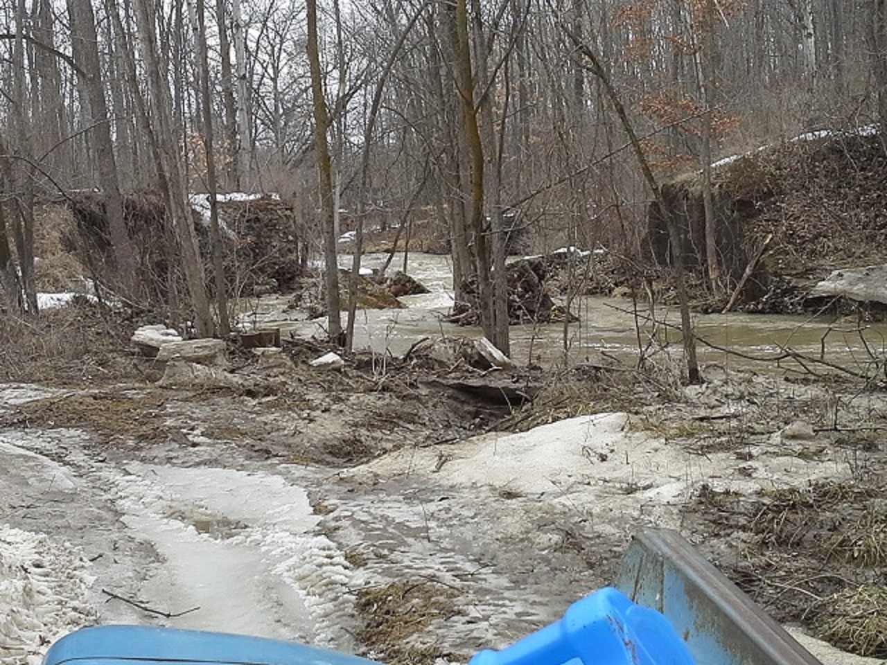

How much does it flood?
A mile and a half down the road (and down the creek), a guy put in some nice piers, a truck flatbed trailer, and built up the approaches. First good gully washer we had, washed out the approaches and shifted the trailer half off the piers. The second gully washer washed the deck downstream a couple of hundred feet and buried 90% of it. Just the one corner is visible.
   / Not an ordinary creek crossing #9
I would set the trailer up a couple feet above the creek bank and fasten it to the footer.
   / Not an ordinary creek crossing #10
This is what your up against being so close to the point where the creek empties into the river. Didn't take this pic to demonstrate the ability of water to move massive objects, but you can make out some very large, heavy abutments that have washed down steam from the the bridge location if you look closely. Pretty similar situation being just upstream of the point this "peaceful" creek empties into the river. My plan is to build a log bridge and secure it by cables to well established trees at each end with a couple other little design enhancements to maybe keep this one in place (already lost my first attempt ;)).
