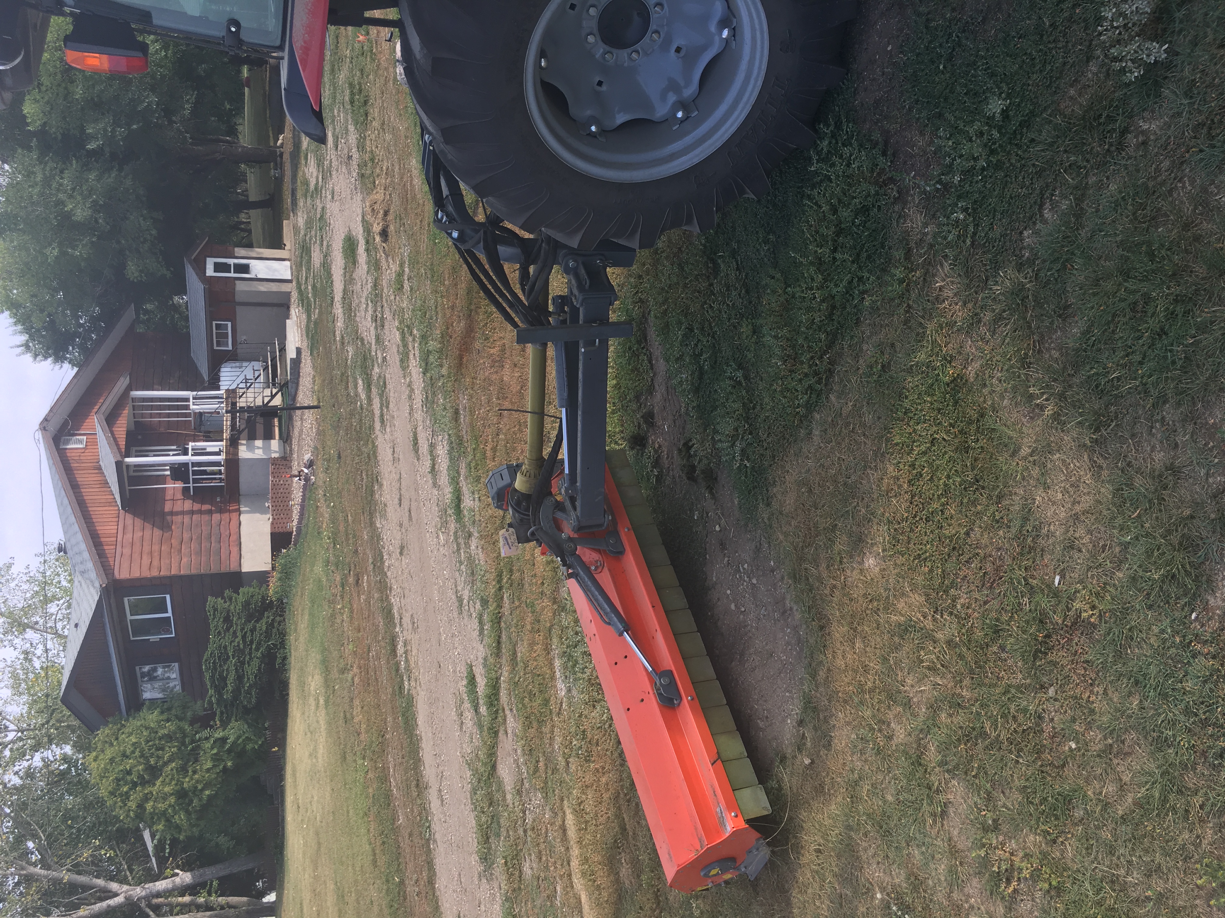

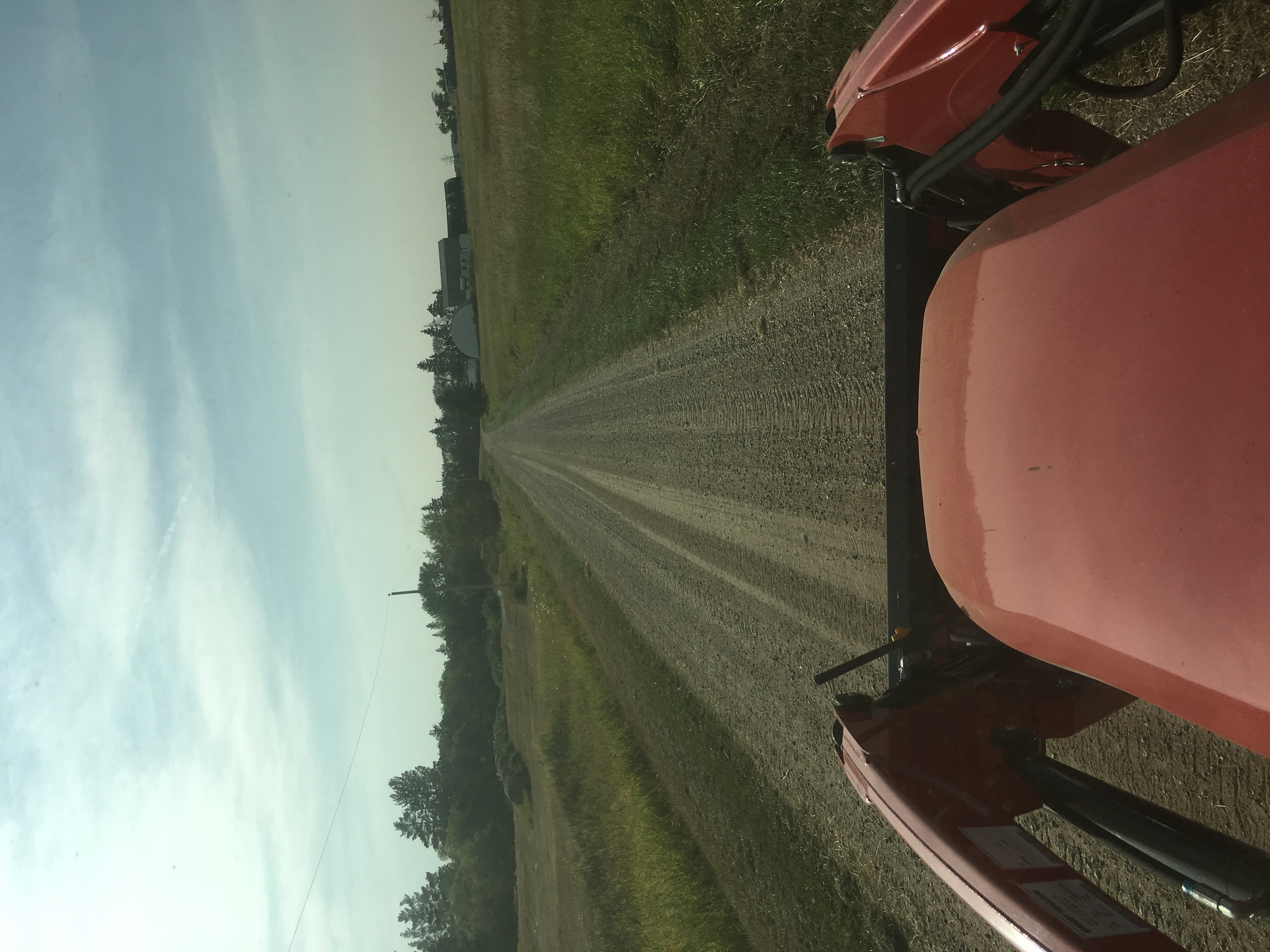

I have a ditch mower with brand name Mateng. Same as the one linked in the last post. Does have limited reach, but works great on steep ditches. Also does the vertical trimming and tucks right behind the tractor for regular mowing duty. Swinging it to vertical really makes cleaning/unplugging a breeze. I needed to add a solenoid to have two functions on the rear remote.

From my phone. Ditch mower 2E856617-C457-4559-97E3-6BCB172F0EBA.jpeg5FED2B21-00B7-4F9D-8B00-8755BBD1B222.jpegB5AEFD28-1CA7-44CF-BC25-F1947066F15A.jpeg

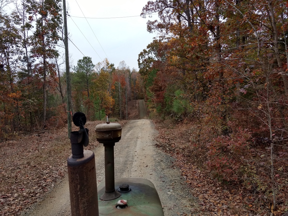

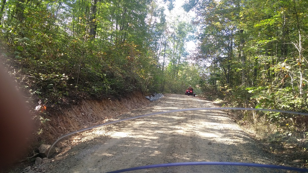

Mainly I am looking to maintain the sides of my 1.5 mile private road. Keeping the brush cleared back makes ditch and road maintenance easier.
The only question is do you need a full boom style? You can get a ditch mower that is wider for way less than half the price of that boom mower. Not knowing all of your applications makes it hard to tell which would be better. A ditch mower works to the side of the tractor too so unless you really need the reach of the boom then a ditch would be a better way to go. The flail head also rotates vertical to 90 degrees on a ditch mower.
http://www.value-leader.com/57-standard-ditch-bank-flail-mower-fh-agl145/
I have been PM'ing Jack Yuan about the ditch mowers and was on the verge of buying one of the Nova models but, A boom mount would be significantly better for my purposes.
