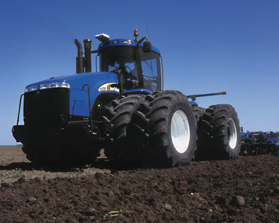

Well, I cannot think of what on earth you'd use 9 remotes for but they are available. It's the New Holland TJ530. One serious machine at 530hp and 489 PTO hp!!
I think one set of remotes is used for the Shiatsu massage unit built into the seat! :D
