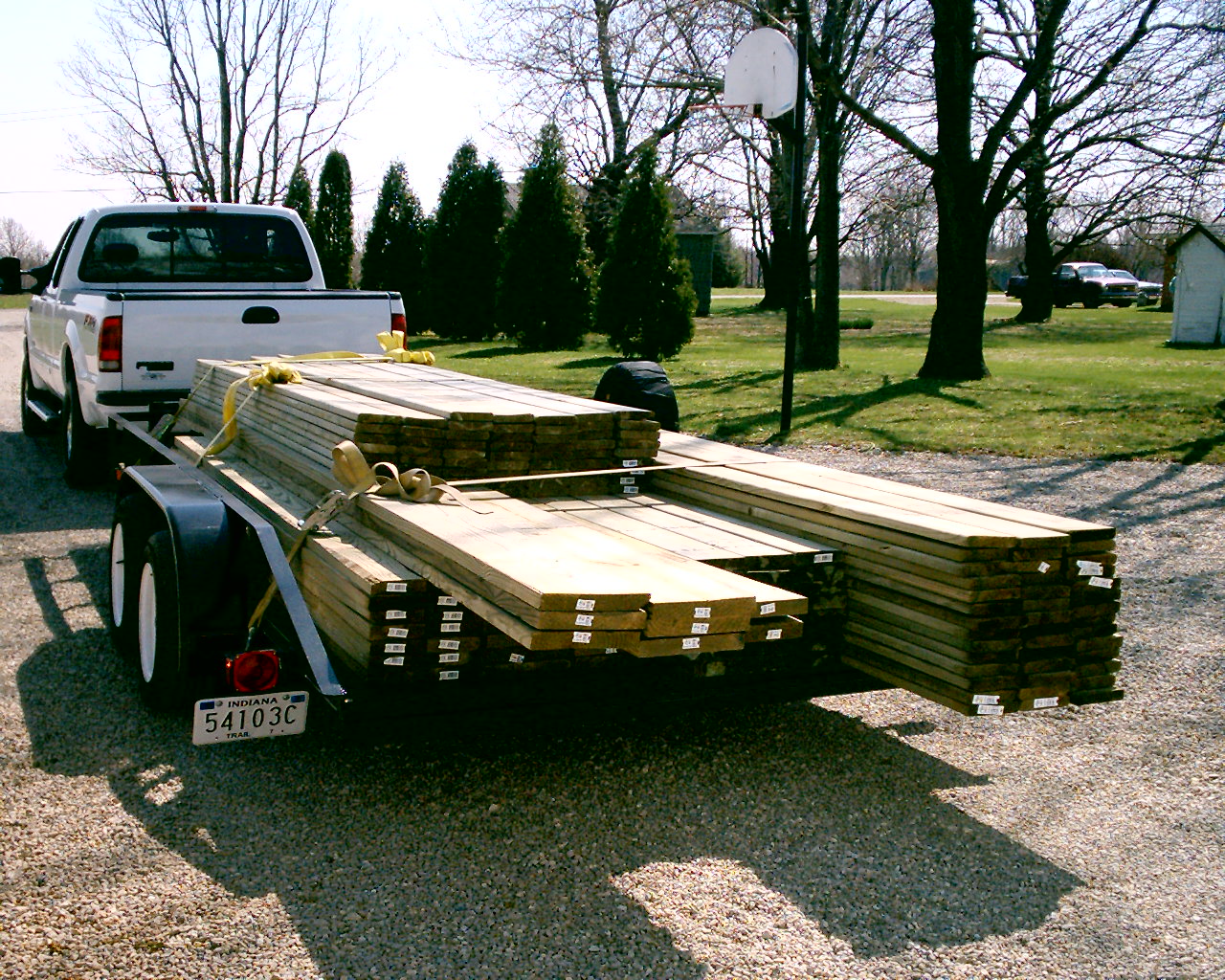

Everything George said is right on the money. Get 82" if you ever plan to do any other hauling. I have a 82" wide by 18' long landscape type trailer. It will haul about 5,750# and has served me well. Prior to that I had a 25' GN with 19,000# load and it was nice but way more trailer than I needed.
I haul around my 5,200# tractor all the time and cars and such.
