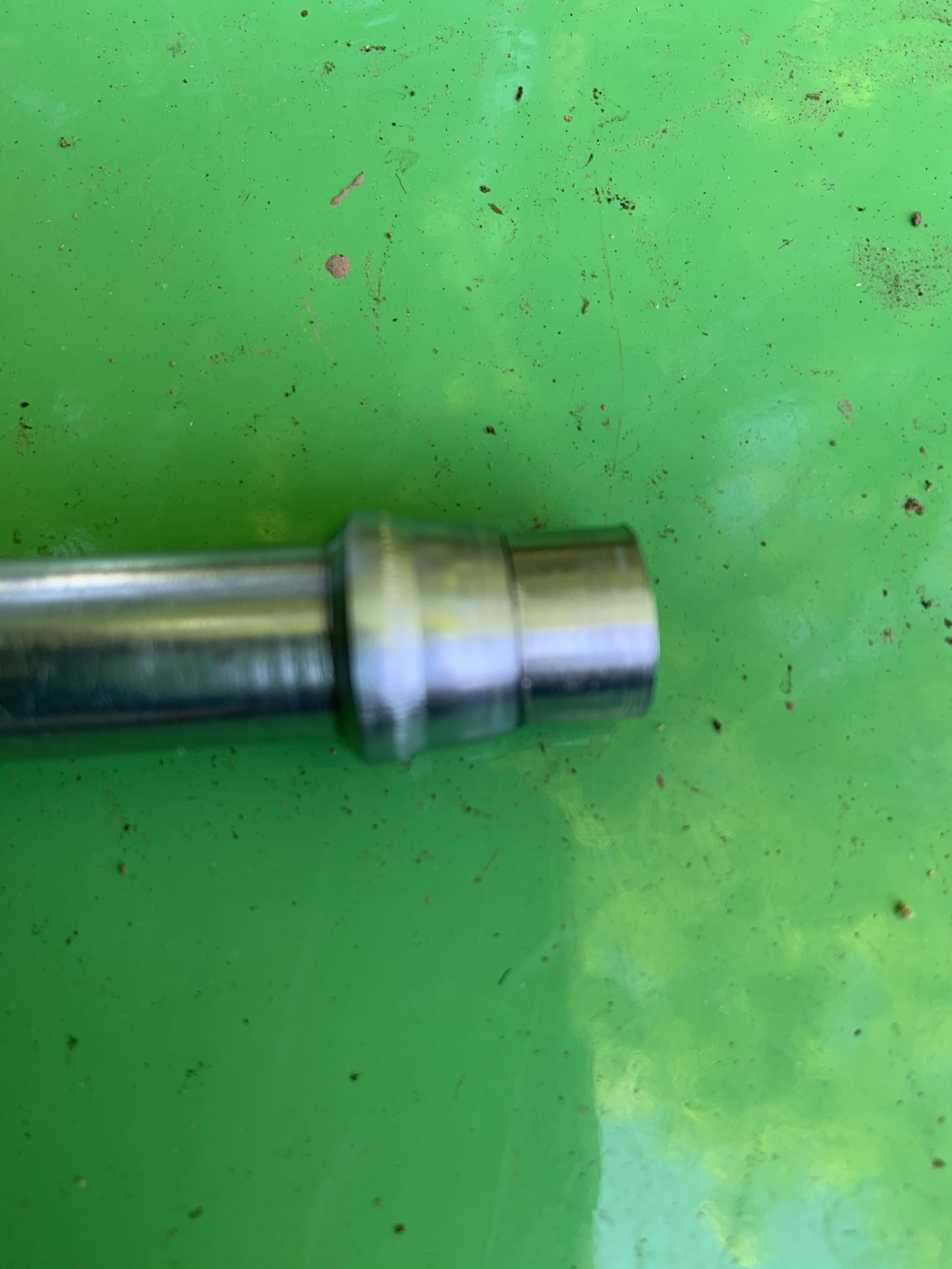

As much as I wanted this mower to be the ticket all for my trails and ditches, it just hasn't delivered. Ordered 23 May, received 4 June. Pretty good, I was pleased.
Day 1 (6 June) - Put it together without a problem, the instructions aren't all that good but it's pretty self explanatory. Quick look over, greased it, filled the gearbox, and off I go. The hydraulic hose connections to the turning cylinder safety valve started leaking. Tightened them a little bit and the leak slowed, but didn't stop. Shut down, sent an email.

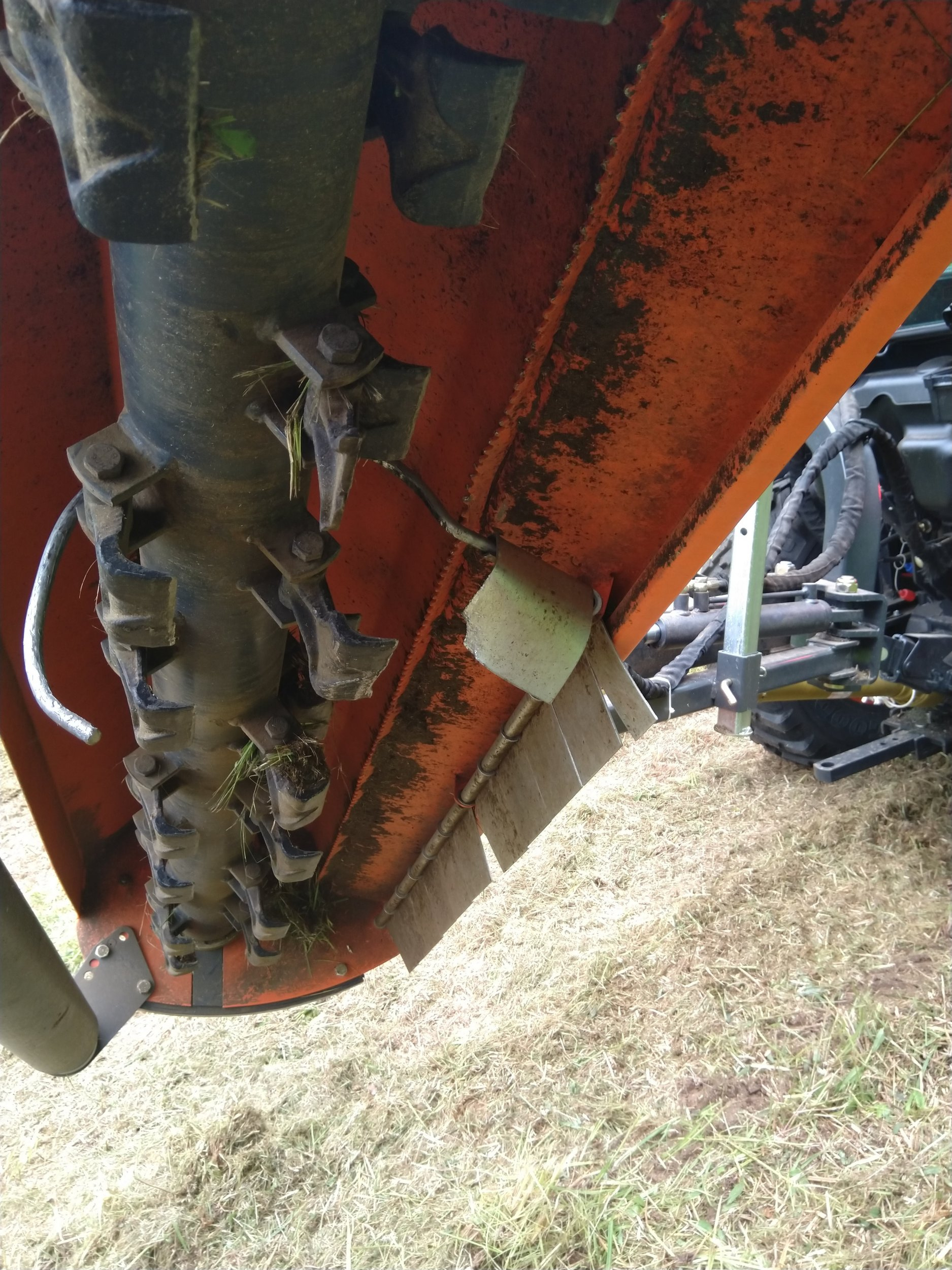

Day 2 - Tightened the connection even more at the suggestion of Jack. Seemed good. It got interesting from there; when I looked it over on day 1 the cotter pins on the protection plate shaft looked kind of small. Sure enough, an hour into it, the cotter pin that holds protection plate shaft on broke. Sending all the protection plates and shaft into the mower. Breaking several hammers and destroying all the plates and the shaft (used all-thread and locking nuts on the replacement shaft and its worked great). Mowed flat and level pasture are the same day and the turning arm snapped. Mower was down for almost 2 weeks waiting on parts from China. During the down time I looked the mower over and found several bolts incorrectly installed. Lock washer on the wrong side of the flat washer, under the head of the bolt instead of the nut, etc. Very disappointed in what I saw, and disappointed that I didn't catch it on the initial look over. Over the course of my limited use I've replaced most of the bolts with grade 8 anyhow.
Received the replacement turing arm and flaps 16 June. Put it together and got a couple hours of mowing out of it. Thumbs up, parked it and moved to other priorities.
23 June - Started experiencing leaks on the fittings that go between the cylinder to the safety valve. Tightened the connections to no avail. After several emails finally got confirmation that replacement parts were on the way...another wait on parts from China, received Jul 12. Got a few days of mowing out of it and now down again. Have a video of the leak but no idea how to attach it. It's about 1-1.5 drip per second from the fitting.
29 July - 2nd turning arm is in bad shape. The mower is off and now it sits again. I'm waiting for a response on an email sent 2 days ago regarding the second turning arm that has deformed to the point that the transport pin cannot be installed, and it looks like it's about ready to break (paint is cracked/krinkled and the turning arm looks deformed from its original shape).
I've gone through 10 hammers in the limited amount of mowing I've been able to do. I've been down about 60% of the time I've had the mower. ~25 usable days vs ~60 days ownership. And I haven't mowed with it every day it's been fully functional either. Been busy laying rock on 1/2 mile of driveway, putting up hay, bad weather, ect. All told, I'd guess I've gotten 5-7 mowing days (20-25 hours) out of it since I've owned it. Grease, look it over, tighten and check bolts before every use.
Customer service has been good from Jack, and I appreciate his help trying to solve the problems. There's a definite language barrier, but he's very helpful. The down time for breaks/repair on this piece of equipment is unacceptable. Would I buy another one? NO WAY!!! I think it will end up at the scrap yard before 2021 is over. I feel this purchase was a waste of $2850. I wish I could return it and buy something more reliable.

I have the Betstco FH-AGL165 version, had a similar issue with the protection shaft, within an hour of using it in grass it ate itself. They sent a replacement right away, got it a few days later and it has been fine since. I did replace the pins with some heavier ones on the new one. All 4 of the connectors leaked when I got it as well, tightening didn't help but loctite 545 sorted it out.

I have the same mower and also lost half my plates, pin must have come out and the rod slid just enough to allow the plates to come off. Luckily it didn't try to eat the rod but I've only found 2 of the plates so far.....
Guess I should give them a call and see if they'll replace them.

I would give them a call for sure, they sent me a new rod and enough plates/washers to get it put back together.

At perhaps 6 hours of run-time a bolt holding the rotor shaft broke and, fortunately, I caught things before there was any catastrophic failure: it put a dent/bulge in the housing, which is some REALLY thick metal. Chalk this up to someone at the factory not tightening things up properly! The maintenance guide does tell you to check every 10 hrs (which seems silly; I've been checking, and since that initial problem nothing has been loose); I suspect they should tell you to check at ZERO hours! I got several replacement re-slicer bars as several had taken a beating when the rotor shifted in its perch.
I also had the cotter pin holding the guard plates on go missing. Again, paying attention (cab provides mirrors and I use them judiciously) was my reward as I saw the thing walking out. Out in the field what are you going to do? Used a circular key ring! (fortunately I'd had my fuel cap keys on me, not a normal state for me, otherwise I wouldn't have had a fix available!). Design issue. I put a heftier pin in it.

Hi, nice to see you here. I m sorry for this trouble happened. I admit this was the fault made by factory. I think you have noticed the difference between the new bracket and the cracked one. This part was not made as how it is designed. I asked the factory mananger to investigate this issue. Then we found out a worker made a very stupid mistake and the QC staff was blind at that time.
Such things often happen in every factory more or less. Life is a roller coaster, I m sorry you got this bad one from us.
Thank you very much for your patience, I will also get in mad if I meet such things.
Anyway, would you like if we recall it sometimes later? We will contact with you soon.
