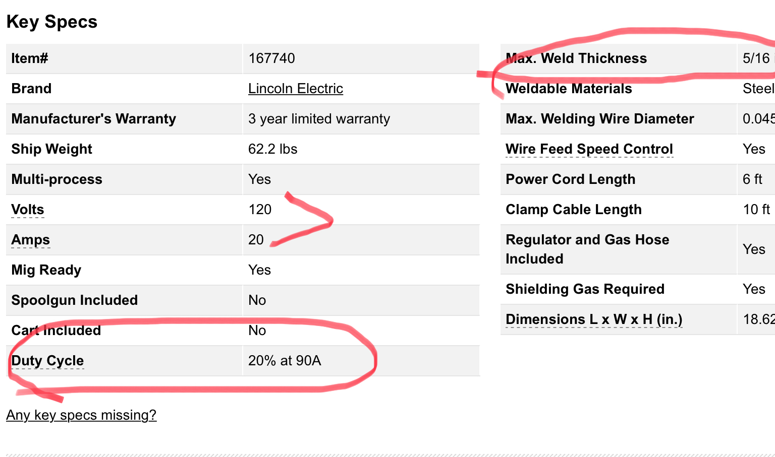

Need something closer to 250 amps for a good job on 1/2” steel.
Look at the specifications page for the machine you are wanting. This is the one for the Lincoln 140
Max Weld thickness is claimed to be 5/16” thick and that’s a long way from 1/2”. A duty cycle of 20% at only 90 amps means you can weld for 2 minutes and you have to sit for 8 minutes even if you are only set at 90 amps, not the full 140.
I do have a couple of the small Lincoln 240 volt welders and while they are Ok for many projects and great for tacking things together, while being much better than their 120v counterparts still leave a lot to be desired when welding things out if there is much welding.
