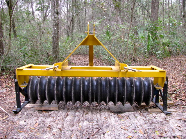

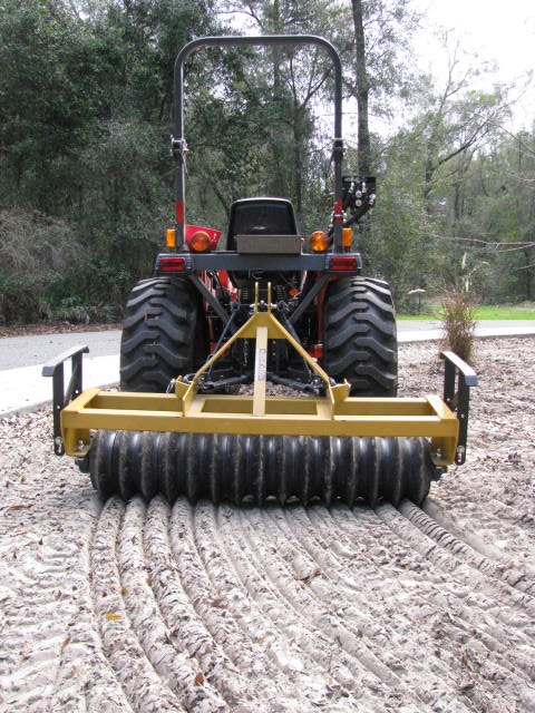

With small seed such as turf and clover is is crucial to roll the seed into the soil.
A cultipacker implement is designed especially for this task. By rolling across the slope, the ridges the cultipacker impresses will also alleviate "washing".
Ideally, you would roll than lay down straw or a straw mat. Soil is generally pretty acid in Maine. I second the soil test for lime. Turf grass prefers "sweeter" soil than the average crop. If the soil is not "right" for your seed germination will be poor.
