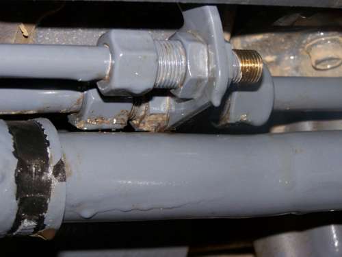

The antifreeze loss was from the drain line clamp blown/pulled off.
After replacing the filter and adding some fluid it still leaks. This picture is a distance shot of the general area of the leak. The fitting that's leaking is behind the unfastened fitting.

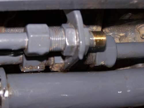

   / Now I did it! Hydraulic filter crash..........
Closer shot

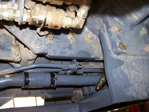

As close as I could get and stay in focus. Man it's hard to get to and I think a 27mm wrench, the only one I don't have.... /forums/images/graemlins/frown.gif

   / Now I did it! Hydraulic filter crash.......... #9
Well as you well know it's one of two things... the female side or the male... finding out which one can be a pain.
I would inspect the female side real close for any hairline crack.
Well all I'm back in the saddle. Had to remove the return line and round up a 27mm wrench. Unfastened the bad fitting and found no trauma to either end. Tighten and filled with fluid, ran it an hour. So far so good! Thanks to all that gave input......... /forums/images/graemlins/laugh.gif
