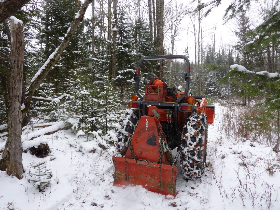

I was inspired by sodamo (THANKYOU) and his thread "Just Another 'Tool Box'" where he mounted a piece of bar stock across the fenders behind the seat to support a tool box. I stole his basic idea and made a shelf for my saw and stuff behind the seat. I used two pieces of 2X2X1/8 angle that I had and mounted them back to back across the ROPS with two pieces of ripped 2 by pressure treated sandwiched between to fill the 3" gap and add stiffness. Then I cut a piece of plywood that rests on the fenders and the new cross support. Not at all fancy as you can see. But now I dont have to carry my saw and everything in the bucket. Wish I did it long ago.

Good deal. Looks like you have space to spare now.

Oh man, I lust after those huge snatch blocks!!!!!!!!!!!!!!!
What model Farmi is that? Another one without a lower block mounted on the winch..interesting.
   / Now I Have a Place for My Saw
The snatch blocks are big. I got a deal on them from a guy who quit doing serious off road stuff in a pickup. I have elongated the eye on one very slightly in using them though. So they arn't to big. My winch is a Farmi 290. Was there smallest. They no longer make it. It has 6500lb pull and is a good match for my 30 hp tractor.
