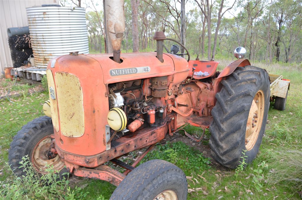

I have just aquired this one with a property we now own. Runs well !
